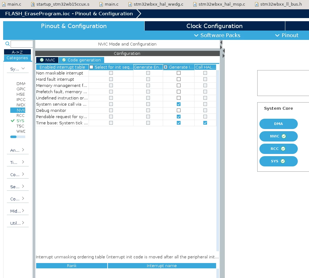

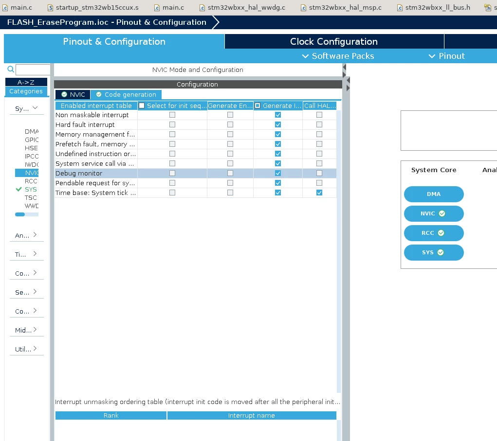

Investigating further I found a difference of FLASH_EraseProgram to WWDG_Example in the NVIC settings. I added "Generate IRQ handler" accordingly and now the program ends in the HardFault_Handler instead of the Default-handler:0693W00000QMxyXQAT.png0693W00000QMy0JQAT.png

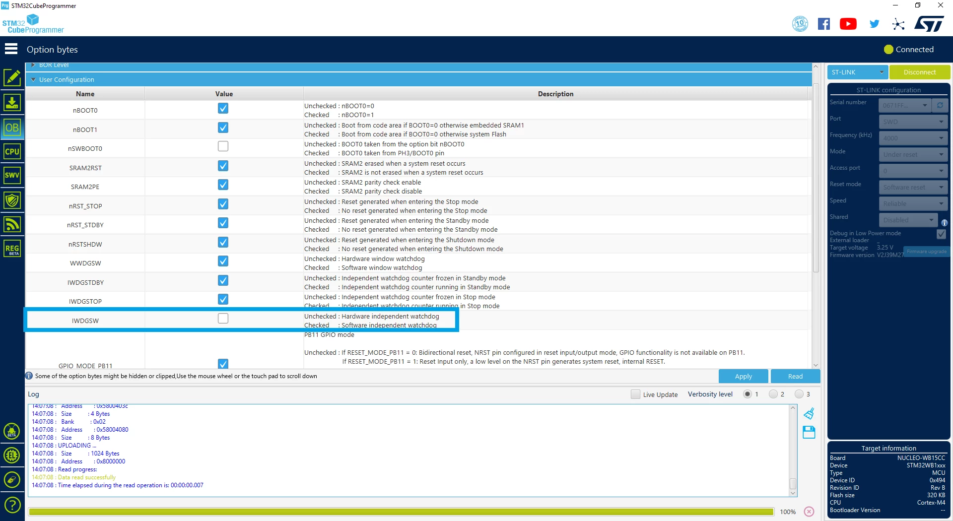

Hello @VSaro.1​
First thanks for posting.
In this case I recommend that you check the user configuration under the Option Bytes for your SOC with CubeProgrammer.
Specifically the IDWGSW it should be Unchecked.
Kind regards,
Semer.

Thanks Semer, it seems to work now.

Hello Semer,
ok, after unchecking IDWGSW it doesn't end in the WWDG_IRQHandler() but...
the program never returns from the call to HAL_FLASHEx_Erase(&EraseInitStruct, &PageError), see line 145 in FLASH_EraseProgram/Src/main.c.
Is there another option maybe?
