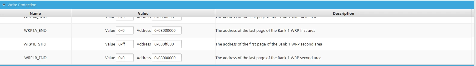

I am using the STM32WB55RG MCU, Bluetooth feature with stack version 1.13.0 and FUS version 1.2.0. Everything was working normal until I tried doing the firmware upgrade of stack from v12.0 to v13.0. I am not able to perform FUS related operations. The version reading shows 0.0.0 for FUS. And following is the log when I hit "Start FUS"

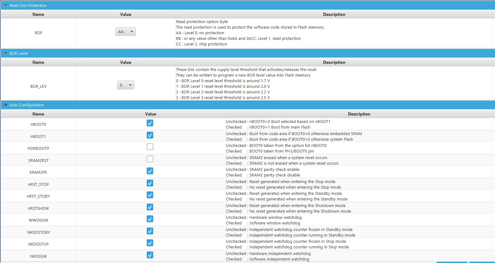

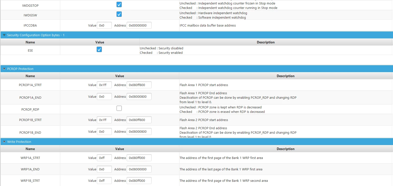

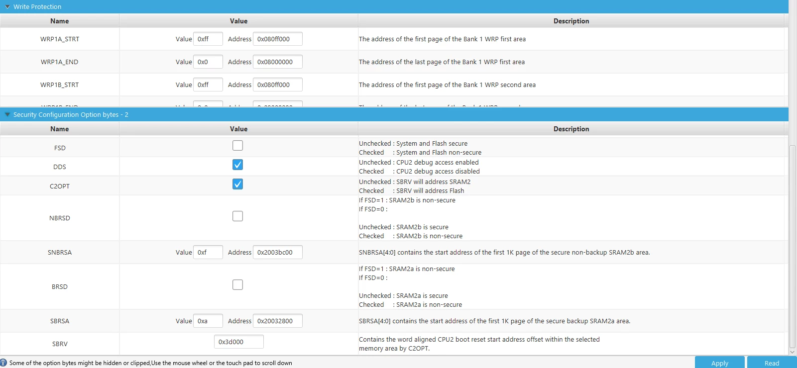

Following is OB info attached. Cube programmer version I am using is : v2.9.0
What could be the issue, please let me know how to resolve FUS and start wireless stack successfully ?

According to your screenshot, SBRV is equal to 0x3D800 that indicate FUS v0.5.3 is running on your board. So, you must update the FUS using the stm32wb5x_FUS_fw_for_fus_0_5_3.bin binary.
