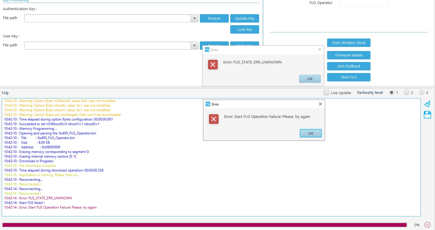

I am using the STM32WB55RG MCU, Bluetooth feature with stack version 1.13.0 and FUS version 1.2.0. Everything was working normal until I tried doing the firmware upgrade of stack from v12.0 to v13.0. I am not able to perform FUS related operations. The version reading shows 0.0.0 for FUS. And following is the log when I hit "Start FUS"
 11:09:47 : Warning: Option Byte: nSWboot0, value: 0x0, was not modified.
 11:09:47 : Warning: Option Byte: nboot0, value: 0x1, was not modified.
 11:09:47 : Warning: Option Byte: nboot1, value: 0x1, was not modified.
 11:09:47 : Warning: Option Bytes are unchanged, Data won't be downloaded
 11:09:47 : Succeeded to set nSWboot0=0 nboot1=1 nboot0=1
 11:09:47 : Memory Programming ...
 11:09:47 : Opening and parsing file: 0x495_FUS_Operator.bin
 11:09:47 :  File     : 0x495_FUS_Operator.bin
 11:09:47 :  Size     : 8 KBytes
 11:09:47 :  Address    : 0x08000000
 11:09:47 : Erasing memory corresponding to segment 0:
 11:09:47 : Erasing internal memory sectors [0 1]
 11:09:47 : Download in Progress:
 11:09:47 : File download complete
 11:09:47 : Time elapsed during download operation: 00:00:00.272
 11:09:47 : Application is running, Please Hold on...
 11:09:47 : Reconnecting...
 11:09:47 : Reconnected !
 11:09:51 : Reconnecting...
 11:09:51 : Reconnected !
 11:09:51 : Error: FUS_STATE_ERR_UNKNOWN
 11:09:51 : Start FUS failed !
 11:09:51 : Error: Start FUS Operation Failure! Please, try again
Following is OB info attached. Cube programmer version I am using is : v2.9.0
What could be the issue, please let me know how to resolve FUS and start wireless stack successfully ?

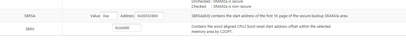

According to your screenshot, SBRV is equal to 0x3D800 that indicate FUS v0.5.3 is running on your board. So, you must update the FUS using the stm32wb5x_FUS_fw_for_fus_0_5_3.bin binary.
Best Regards

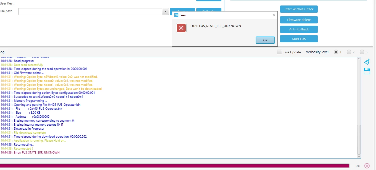

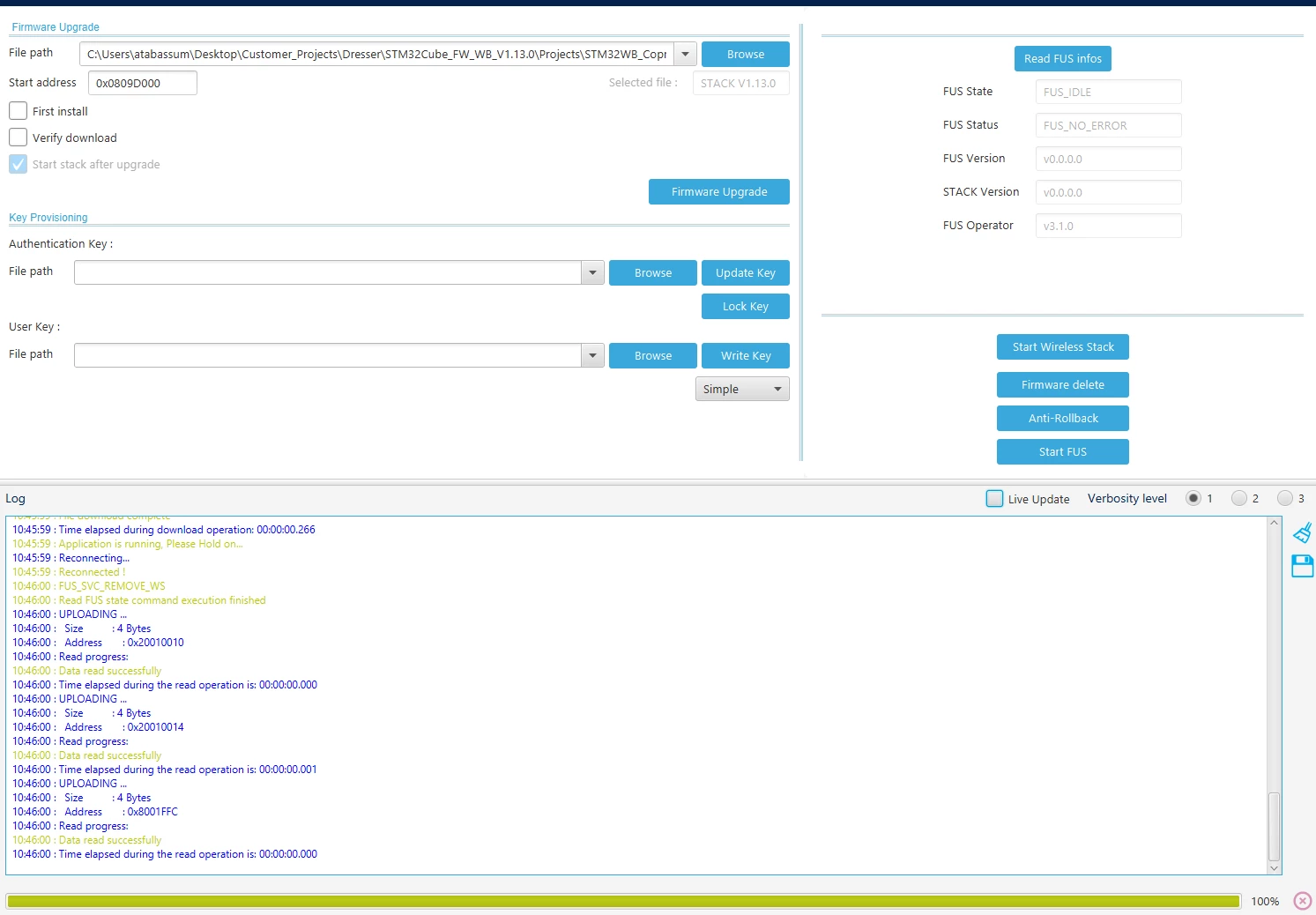

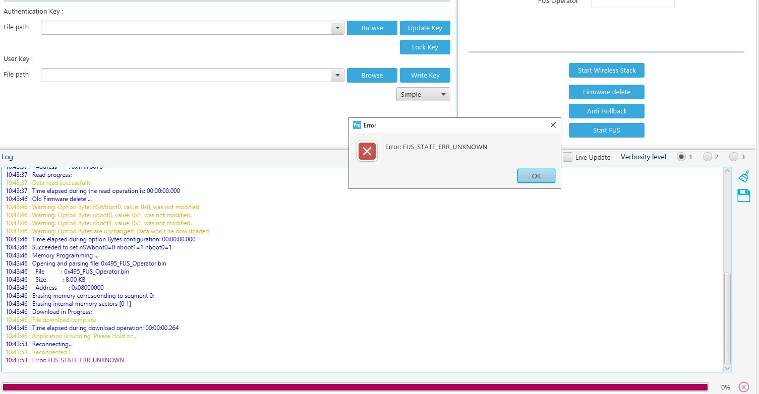

  1. Start FUS shows following error:
0693W00000KbynJQAR.png2. Upgrade FUS shows:
0693W00000KbypNQAR.png3.Upgrade wireless stack shows:
0693W00000Kbyq1QAB.pngAnd when these errors occur, if I read FUS info after these I see the following:

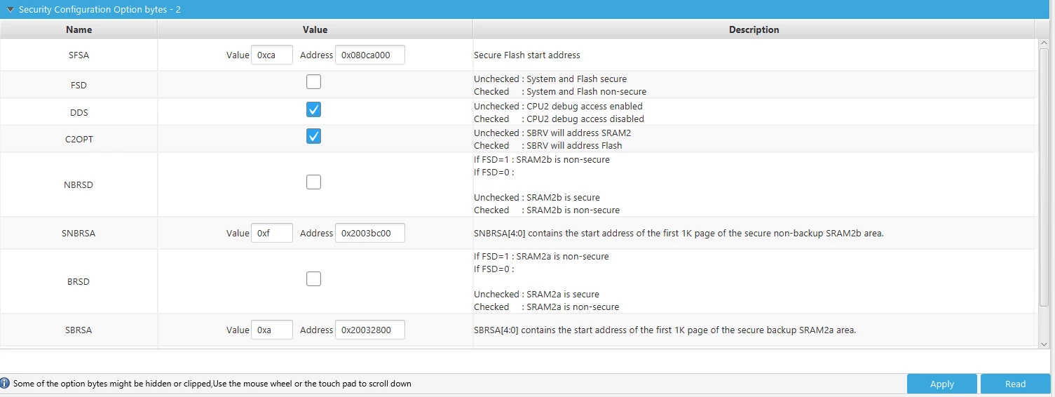

Could you take a screenshot of Security Configuration Option Bytes - 2 ?
Best Regards
ATaba.1
ATaba.1Author
Mar 9, 2022 4:12 PM UTC
Sure, following is the screenshot:
Remy ISSALYS
Mar 9, 2022 4:27 PM UTC
Miss SBRV option byte
ATaba.1
ATaba.1Author
Mar 9, 2022 4:28 PM UTC
Sorry about that, here it is:0693W00000KbzEcQAJ.png
