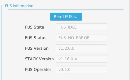

Unable to flash wireless stack to nucleo WB55RG
I am trying to do some testing with the new Matter protocol and using Thread and BLE on the Nucleo STM32WB55RG. Installing the new wireless stack firmware (found on the STM32 GitHub Hotspot), went just fine.
After using the nucleo for a different usecase, I tried to reinstall the correct copro wireless binaries. By accident I activated the anti-rollback option in STM32CubeProgrammer previously.
Now I cannot update the wireless stack back to stm32wb5x_BLE_Thread_ForMatter_fw.bin from the STM32 Hotspot or even stm32wb5x_Thread_FTD_fw.bin from the CubeWB-1.16.0.
Is there a way do disable the anti-rollback or get a newer version of the stm32wb5x_BLE_Thread_ForMatter_fw.bin firmware?

TStro.2
TStro.2Author
Apr 20, 2023 2:57 PM UTC
Hello Remy,
At the moment, only the stm32wb5x_BLE_Stack_full_fw.bin from V1.16.0 will successfully install on the nucleo.
Trying to install other wireless stacks, the stm32wb5x_Thread_FTD_fw.bin or stm32wb5x_BLE_Thread_dynamic_fw.bin will give the anti-rollback error.
I would assume that they should be possible to install on the nucleo since they are from the same release?
Looking at the release of v1.0.1 for the Matter over Thread example, that firmware is based on the v1.15.0 stack release.
Thanks in advance.

TStro.2
TStro.2Author
Apr 21, 2023 8:59 AM UTC
Reading the FUS information gives the following results:
_legacyfs_online_stmicro_images_0693W00000biZGpQAM.pngTrying to install the following wireless coprocessor binaries give me the anti-rollback error message:
  • stm32wb5x_Thread_FTD_fw.bin

10:24:56 : Error: Rollback to older version of FW detected and not allowed!:
  • stm32wb5x_BLE_Thread_dynamic_fw.bin

10:22:19 : Error: Rollback to older version of FW detected and not allowed!:
Only stm32wb5x_BLE_Stack_full_fw.bin will succeed.

10:29:23 : Read progress:
10:29:23 : Data read successfully
10:29:23 : Time elapsed during the read operation is: 00:00:00.000
Is there any solution to allow the installation of those other binaries?
Can stm32wb5x_BLE_Stack_full_fw.bin be used to replace stm32wb5x_BLE_Thread_dynamic_fw.bin?
Best Regards
Remy ISSALYS
Apr 26, 2023 4:21 PM UTC
The version of BLE Full stack (stm32wb5x_BLE_Stack_full_fw.bin) is v1.16.0.4. The version of Thread FTD stack (stm32wb5x_Thread_FTD_fw.bin) and BLE Thread dynamic stack (stm32wb5x_BLE_Thread_dynamic_fw.bin
) are v1.16.0.0. That's why in your case, you can't change the wireless stack from BLE Full stack to Thread FTD or BLE Thread dynamic stack. So, the only solution is to wait the next STM32CubeWB release v1.17.0 or to buy another board.
You can't replace stm32wb5x_BLE_Thread_dynamic_fw.bin by stm32wb5x_BLE_Stack_full_fw.bin.
Best Regards
