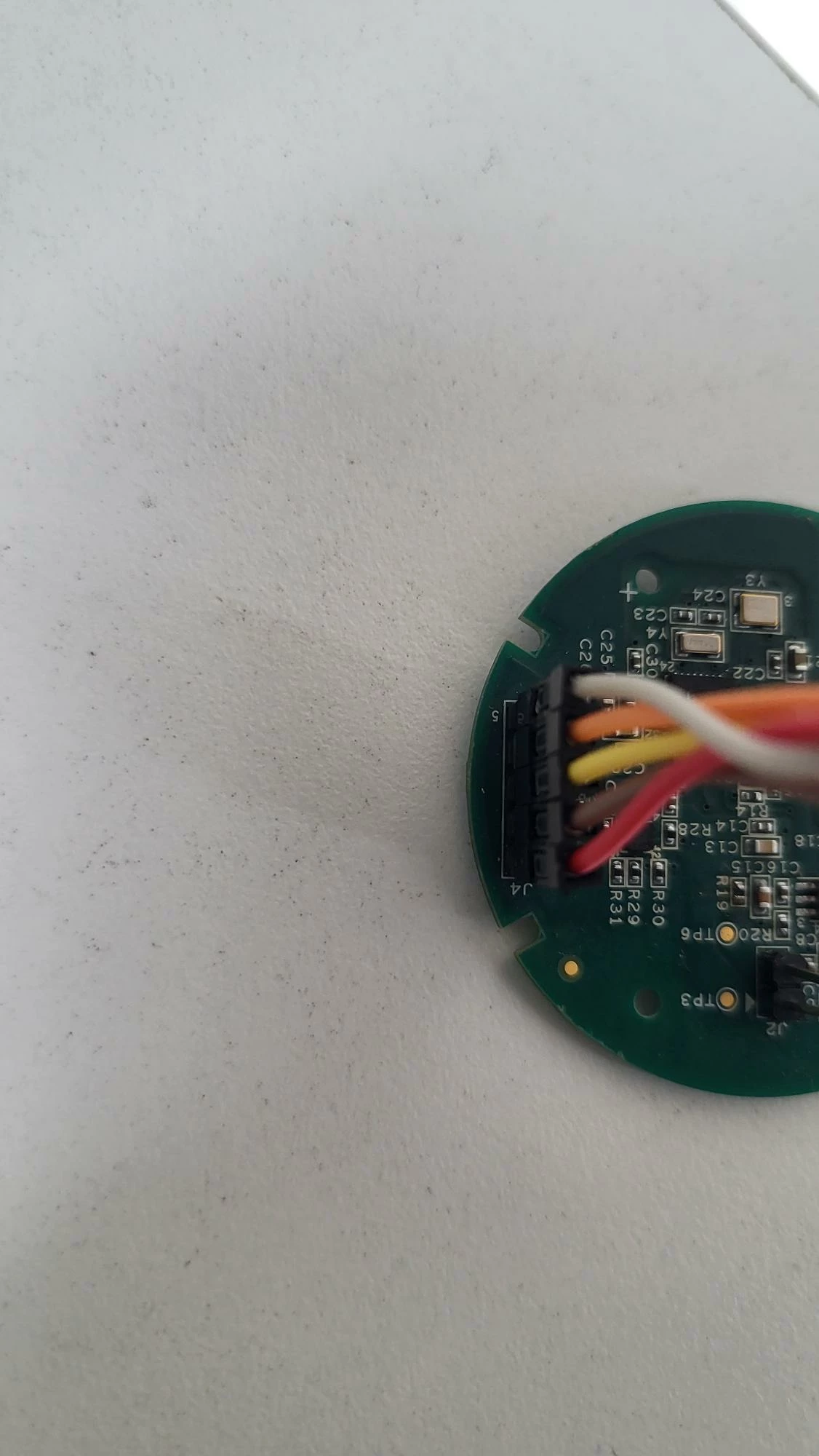

I'm currently working with a BlueNRG-332AC and am unable to establish an SWD connection for programming/debugging.
Hardware Checks
  • Verified the SWD header continuity – all connections are OK.
  • Tried swapping SWDIO and SWCLK to rule out wiring issues, but it made no difference.
  • The target board is powered.
Voltage Measurements on SWD Header
Pin Measured Voltage
Pin 1 (VCC) 3.3 V
Pin 2 3.3 V
Pin 3 (SWDIO) 3.3 V
Pin 4 (SWCLK) 0 V
GND 0 v

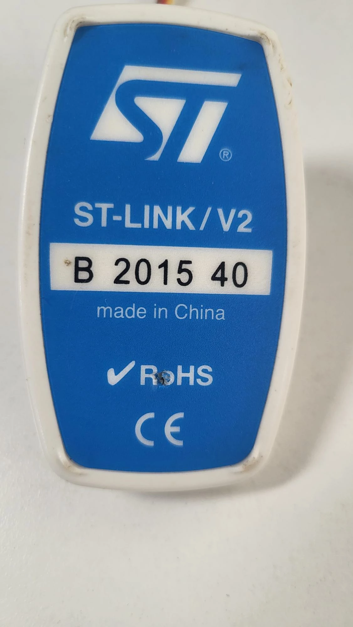

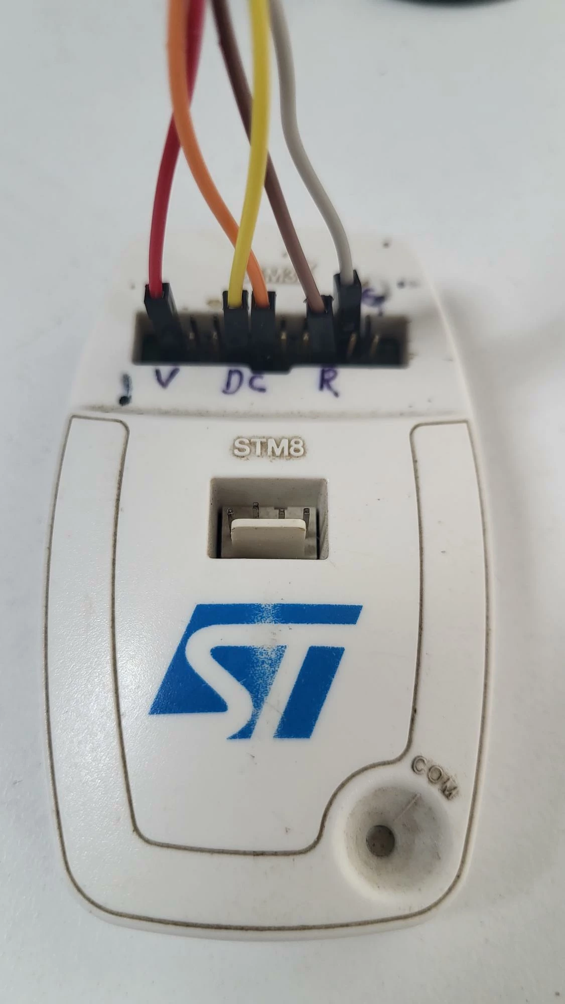

Peter BENSCH
Jul 6, 2026 1:55 PM UTC
Could you please include a photo of your hardware showing the SWD connection to your computer?
If it is an ST-LINK/V2 in a plastic housing, please also include a photo of the back.
Regards
/Peter
Andrew Neil
Jul 6, 2026 3:13 PM UTC
​@avinpat_8 - I think what Peter’s hinting at is:
avinpat_8Author

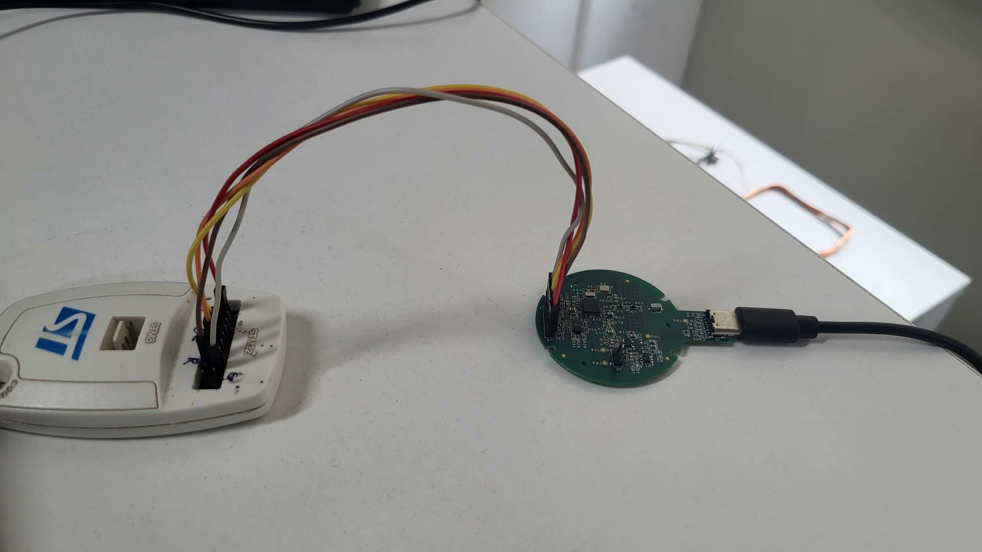

Jul 14, 2026 5:52 AM UTC
I have attached the images. The BlueNRG-332AC board is powered through a USB Type-C cable, and I am measuring 3.3 V at the J4 VCC pin. The ST-LINK/V2 programmer is also powered through USB and is connected correctly.
Please review the setup shown in the attached images.
avinpat_8Author
Jul 7, 2026 5:15 AM UTC
avinpat_8Author
Jul 7, 2026 1:51 PM UTC
And also I have observed one thing the pA10 pin is at high is this causing issue

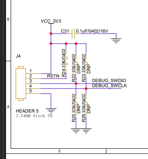

Laurent LOUAZON
Aug 20, 2026 8:59 AM UTC
Can you share your entire schematics?
Regards
Laurent

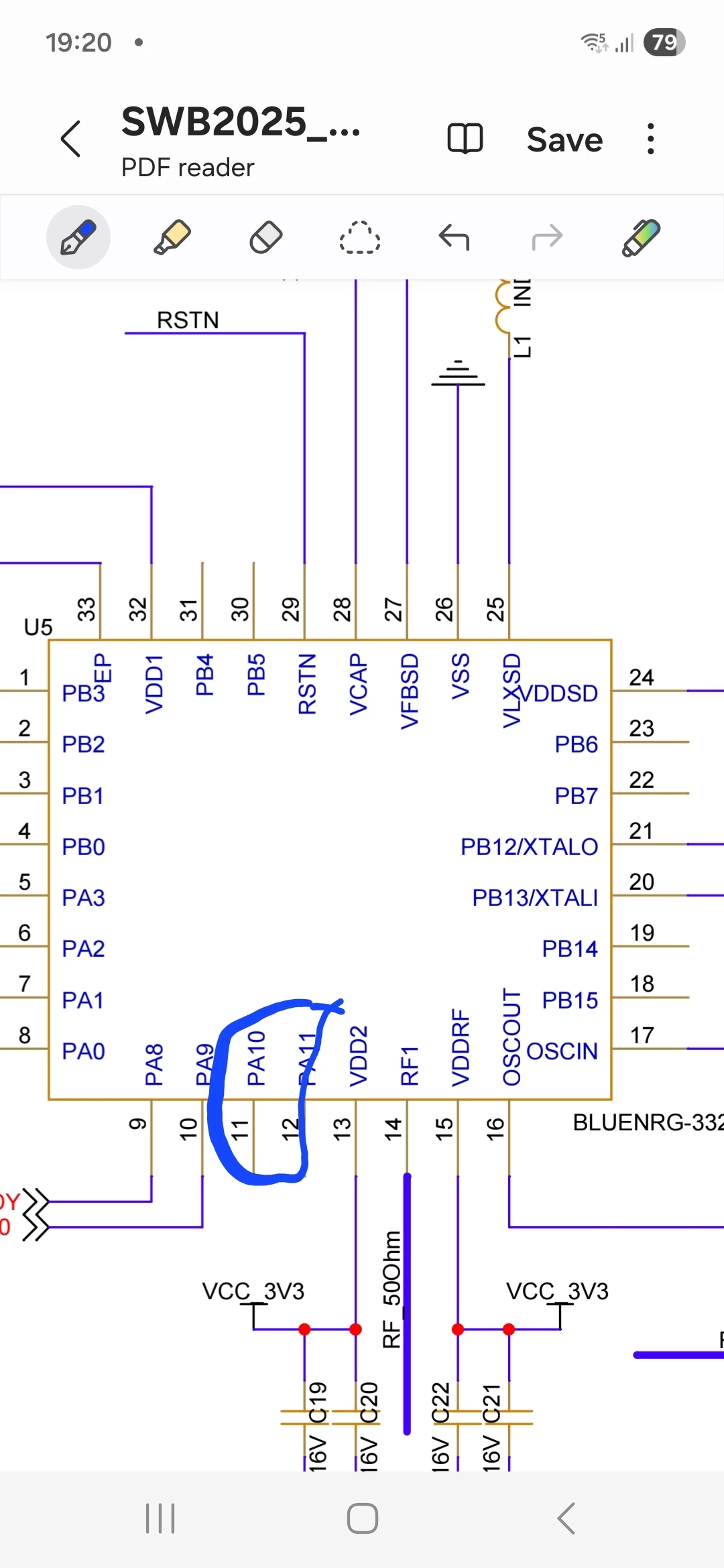

avinpat_8Author
Aug 20, 2026 10:28 AM UTC
Hi @ Laurent
I have attached schematic please take a look at it once and let me know as soon as possible since it was pending from long time.
Laurent LOUAZON
Laurent LOUAZONBest answer
Aug 20, 2026 12:45 PM UTC
Schematics
I see two big problems
- C27 must be 220nF and not 10uF
It is decoupling cap for internal LDO voltage that creates 1.2V core voltage.
It might happen internal LDO is not stable with 10uF. Have you checked Vcap level is 1.2V?
- C23 and C24 are too high.
Those caps are here to center LSE frequency.
I do not know load cap of 32kHz xtal selected, but if using a 6pF Xtal, C23 and C24 will be around 10pF (twice Xtal load cap minus parasitics). In any case 100nF is too high.
It might happen LSE is not functional.
Other comments (to consider but that are not related to problem you are facing)
- What is L1 value? It should be a 10uH with lows ESR and 100mA min as rating current.
- R24 is not needed (reset in internally pulled up) but a 100nF decoupling cap is recommended
- I also recommend a test point on PA10.
If an application is running inside BlueNRG and low power is used, SWD interface cannot be accessed.
It is then needed to use PA10 pin for forcing boot mode. See below wiki page
STM32WB0 device debug and access in low-power mode - stm32mcu
- See a HW reference design for BluenRG-332 (also named STM32WB05) with below link
https://www.st.com/en/evaluation-tools/stdes-wb05kv2ld.html#cad-resources
- RF matching/filtering implemented is not correct.
See the example in reference design or  AN5526.
Please let me know if this helps
Laurent
