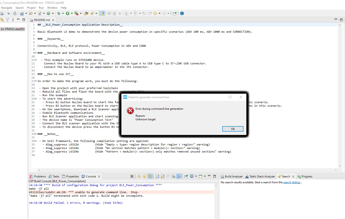

Unable to build example projects NUCLEO-WB05KZ
STM32CubeIDE
Version: 1.12.1
Build: 16088_20230420_1057 (UTC)
I am trying to use one of the examples from the STM32Cube_FW_WB0_V1.1.0 package, but I am unable to build any of them.
After importing the project into STM32CubeIDE (I have tried BLE_Beacon and BLE_Power_Consumption), I attempt to build it, but I get the error shown in the image.
At this point, I have to force close CubeIDE from the Task Manager because the program gets stuck with hundreds of error windows popping up.
I'm obviously missing a step, but I can't figure out which one. Has anyone encountered this issue before?

Hello @utelettronico2
The STM32CubeWB0 has been supported on the V1.16.0 of the STM32CubeIDE. So, could you please try to use the last version of the STM32CubeIDE (V1.18.0).
The CubeIDE-1.12.1 does not support WB0 series, please upgrade your CubeIDE to the latest version.
