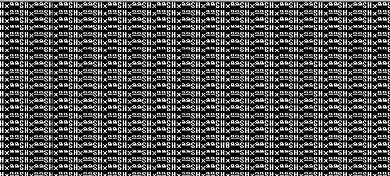

UART data not matching
data on serial  monitor
tera term setting
what is the reason of data mis matching ?

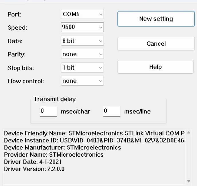

Check the TeraTerm Setup / Terminal settings "Coding (receive / transmit)".

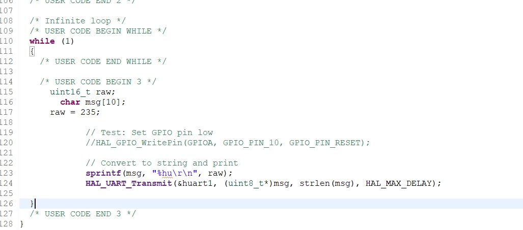

And do you have any proof that sprintf is working correctly?
Try sending some pure ASCII string directly with HAL_UART_Transmit.

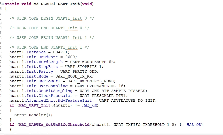

You have different paritysettings. Put parity none to code or parity odd to your terminal settings.

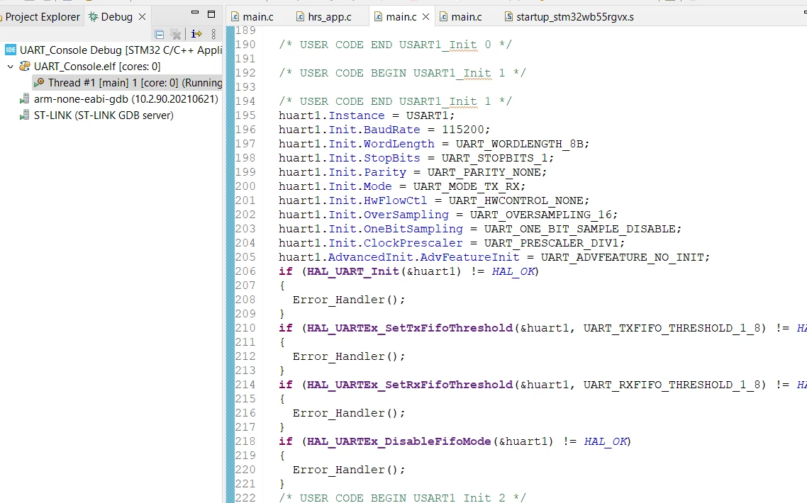

putt the parity non now the result is

What about baudrate in terminal, now its 115k2 in mcu

Currently outputting in the equivalent to 7O1 mode, disable parity on the STM32 (NONE) so it is using 8N1 mode

putt the parity none,now the result is
