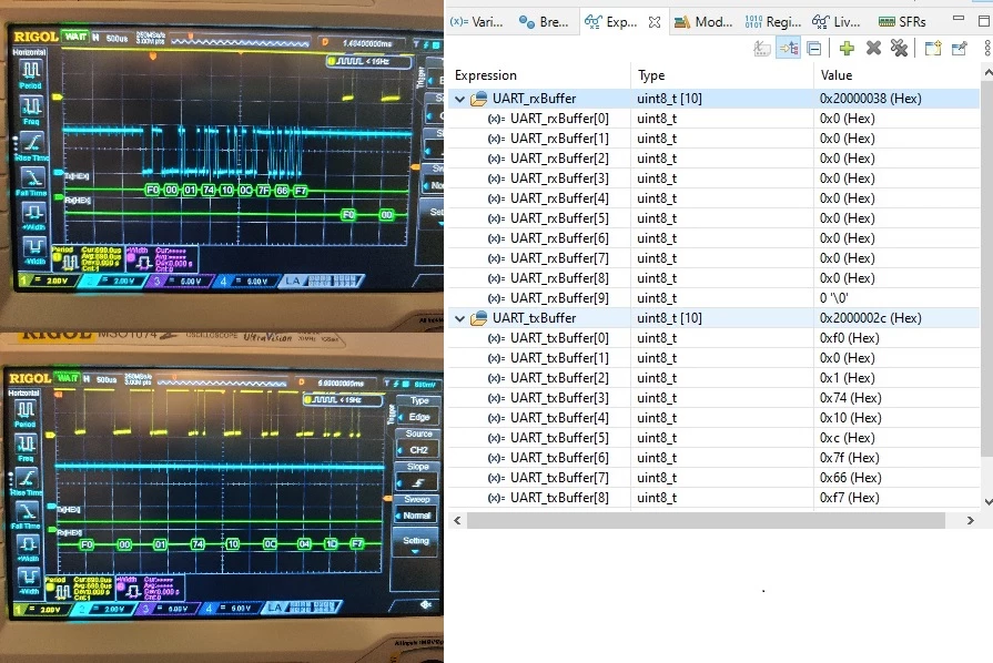

Ok, looks like I'm back with more info!
I went ahead and hooked up a scope and, as I suspected, the data was being sent out and received correctly (which is a fun bit of news!). Unfortunately, the microcontroller seems to be catching the interrupt but it's not reading the data in (it's reading all 0's . . .).
The blue signal is the transmit, the yellow signal is the receive. I did update the code again to start with the first position of the array (as discussed previously).
 uint8_t UART_txBuffer[10] = {0};
 if(HAL_UART_Transmit_IT(&hlpuart1, &UART_txBuffer[0], 9)!= HAL_OK)
 	Error_Handler();
uint8_t UART_rxBuffer[10] = {0};
void HAL_UART_RxCpltCallback(UART_HandleTypeDef *UartHandle)
	/* Set transmission flag: transfer complete */
	HAL_UART_Receive_IT(&hlpuart1, &UART_rxBuffer[0], 9);
What's interesting is my code works fine when I have my Tx and Rx lines tied together, so I assume it has something to do with the way the hardware is sending the data across. One thing worth noting is that the interrupt fires from the external hardware the first time, but not any additional times (though if I restart the firmware, it will receive the interrupt again, so something is getting reinitialized).
I assume, based on the above, there's data left in the register that's not being grabbed and the reason it works when restarting the firmware is it's clearing the UART register or a flag of sorts. So, I guess this leaves me with 2 questions:
1) How do I get the firmware to collect the data? Do I need a for loop to grab it byte by byte?
2) What is causing it to hang? Do I need to clear a flag or something to that effect to allow it to retrigger?
I assume these errors are related but I'm not 100% sure what's going on.
Thanks for your help!
waclawek.jan
Nov 22, 2020 10:48 PM UTC
Read out and check/post content of UART and relevant GPIO registers.

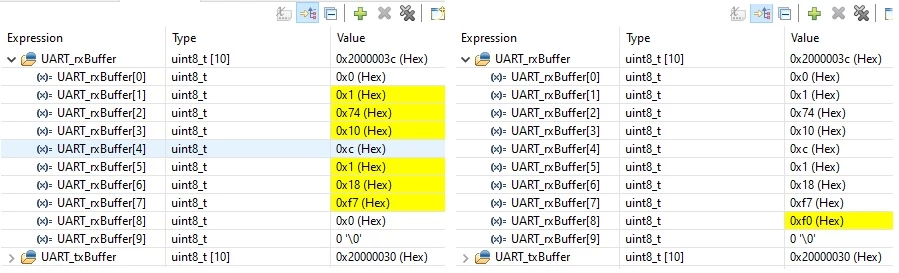

0693W000005CEFiQAO.jpgI went ahead and went back through the datasheet and came across the ORE flag, which I remembered I had cleared in another application I had (as well as the NE flag, for whatever reason). I added them both and the code appears to send the data across. That said, I'm not 100% sure this is what resolved the issue as I tried to reproduce the issue by unplugging the board from the PC and running the code with the cleared flags removed and I now can't seem to recreate the error I had last night. Not sure if I knocked it into a weird state or if something I did resolved the issue.
That said, my code was essentially changed to this:
void run_main()
	if(!HAL_GPIO_ReadPin (GPIOC, GPIO_PIN_4))
		XOR_Checksum_Calc(&UART_txBuffer[0]);
		//if(HAL_UART_Transmit_IT(&hlpuart1, &UART_txBuffer[0], sizeof(UART_txBuffer))!= HAL_OK)
		tempReceiveCount = 0;
		//Clear Overrun Error Flag
	 __HAL_UART_CLEAR_OREFLAG(&hlpuart1);
		//Clear Noise Error Flag
	 __HAL_UART_CLEAR_NEFLAG(&hlpuart1);
			Error_Handler();
	//HAL_UART_Receive_IT(&hlpuart1, &UART_rxBuffer[0], sizeof(UART_rxBuffer));
	//HAL_UART_Receive_IT(&hlpuart1, &UART_rxBuffer[tempReceiveCount], 1);
	//tempReceiveCount = (tempReceiveCount + 1) % 9;
However, I now, of course, have a different issue. It seems to be missing the first byte. I am receiving all the data as expected (00 01 74 10 0C CH CS F7), but I'm missing the F0 at the beginning. When I run it a second time, it would appear the first byte of the new command is in the final byte (8) of the previous command and that first byte is missing in the next set of values as well (see screenshot attached).
I tried reading the data one byte at a time (shown by the commented out section in the interrupt function) but got a similar result.
I was trying to do a while loop around the RXNE flag but can't seem to find a way to actually poll it (started going through the stm32wbxx_hal_uart.h and such files but can't seem to find a way to read a flag status that isn't already a macro, like with the ORE and NE commands). Was going to try and read bytes until that flag goes low (not sure if that would work anyway).
I tried going through the forums but haven't had much luck. I can technically work with what I have since the first byte isn't actually essential (it's always the same value, assuming the data is correct, obviously) but I would like to figure out the source of the issue and see if I can resolve it.
Any chance there's a forum post/topic/link suggestion you can point me to to determine the source of this problem? Once again, feels like I'm close but I'm kinda grasping at straws at this time.
KnarfB
Nov 23, 2020 5:54 AM UTC
ORE = overrun, so the UART was not read fast enough when the (first?) char arrived. Are you calling HAL_UART_Receive_IT before HAL_UART_Transmit_IT? You can safely do so if the other side waits with the response for your request. Does enabling the FIFOs help? If you know the length of the answer, you can easily go with DMA which is less CPU intensive.
