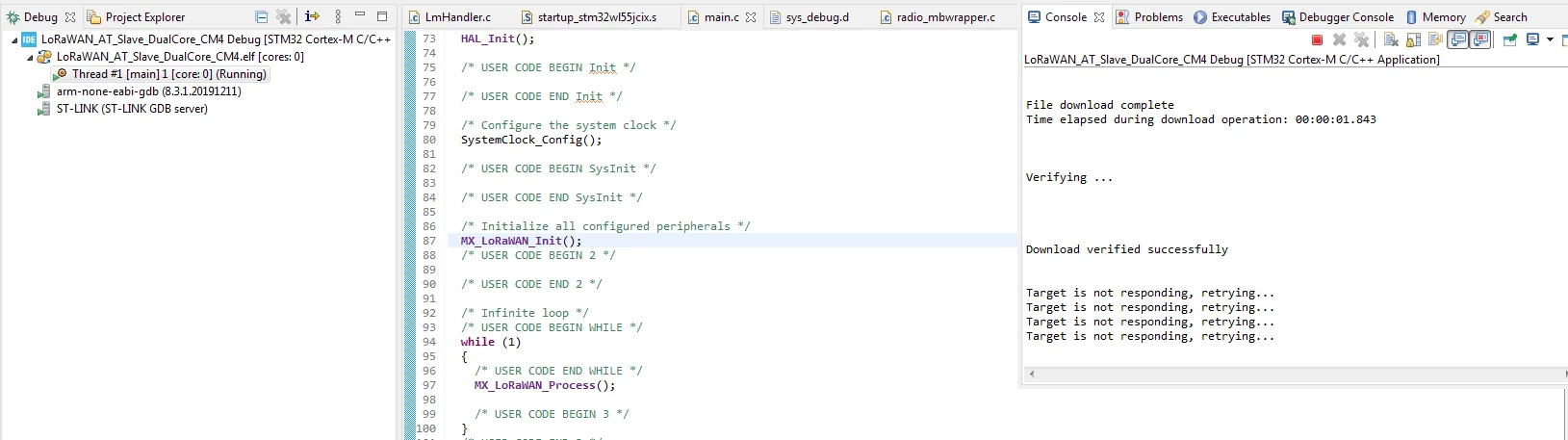

After implementing either of the above changes to allow the build to complete, I set up a debug configuration flash both images and attach the debugger in the M4's context.
The binaries both seem to download successfully, however running the program returns the following error over the device's UART:

I have been able to make it work replacing files and changing optimisation flags.
I still have problems debugging but I will open another issue if necessary.

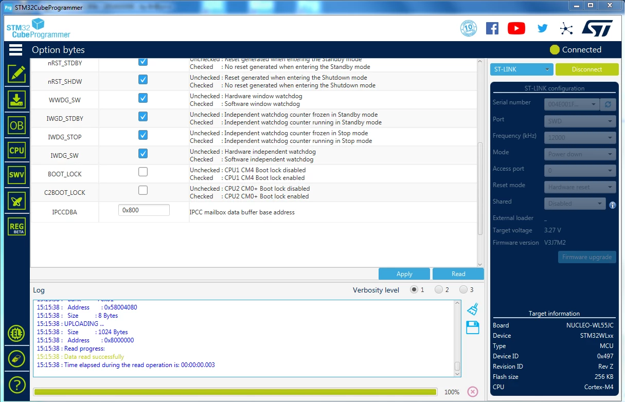

The option byte IPCCDBA probably does not match MAPPING_TABLE address in the linker file at STM32CubeIDE\CM4\STM32WL55JCIX_FLASH.ld.
  • MAPPING_TABLE is mapped at RAM_SHARED (@0x20008000). Mapping table is used to exchange data between the cores.
  • To see IPCCDBA, connect with cube programmer, open tab 'OB', section 'User Configuration', scrolling down to bottom you will find it.
following rule shall apply IPCCDBA = (MAPPING_TABLE>>4)
please try to program manually option byte IPCCDBA to 0x800. The board will restart to reload the new OB value.

Even after modifying manually the IPCCDBA in stm32cubeprogrammer, I have the same issue in cubeide.

After changing OB to 0x800, they still don't match. It's looking for 0xe4.
