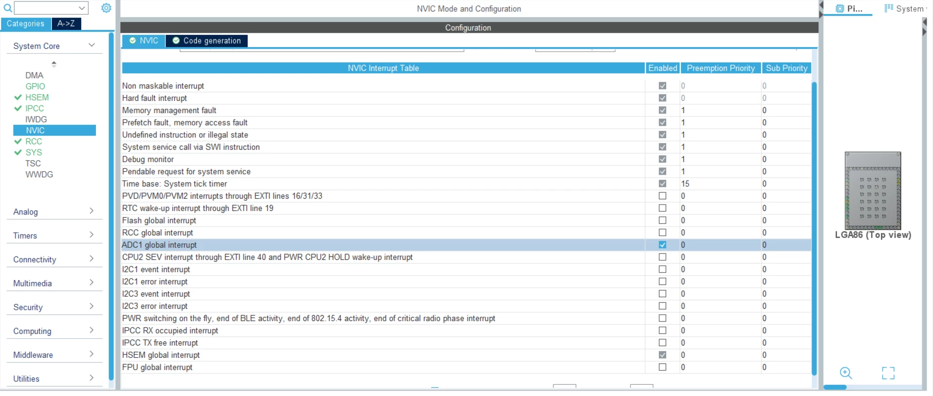

I am using Zegbee messaging cluster on STM32WB55 to send messages between some Zigbee end devices and a coordinator.
Each end device measures the temperature via I2C sensor and sends a message with the temperature value to the coordinator and then goes to sleep mode for 5 seconds. The software works well.
But when I try to also measure the reference voltage to send its value with the temperature value in the message, the software freezes!
In app_zigbee.c:
static void APP_ZIGBEE_InitMsg(void)
APP_DBG("APP_ZIGBEE_InitMsg");
 uint8_t buf22[59];
 memset(buf22, '\0', sizeof(buf22));
 char buf0[]="TM+1+";
 strcat(buf22, buf0);   // Adding some text to the meassage
 uint8_t buf2[3];
 memset(buf2, '\0', sizeof(buf2));
 float temp_c2 ;
 temp_c2 = TMP117_get_Temperature2(hi2c3); // measuring the temperature
 sprintf((char*)buf2,"+%d",
 ((int)temp_c2 / 100));
 strcat(buf22,buf2);     // Adding the temperature value to the message
 uint16_t u16VRefMilliVoltsValue = 0;
 uint16_t g_u32ReadVRefDigitalValue = 0 ;
 HAL_ADC_Start( &hadc1 ); // Trying the start the ADC to measure the reference voltage
// The software freezes in this block!!!!!!!!!!!!!!!!!!!!!!!!!!!!!!!
if(HAL_OK == HAL_ADC_PollForConversion(&hadc1, 50))
g_u32ReadVRefDigitalValue = HAL_ADC_GetValue(&hadc1);
u16VRefMilliVoltsValue = __HAL_ADC_CALC_VREFANALOG_VOLTAGE(g_u32ReadVRefDigitalValue, ADC_RESOLUTION_12B);
 HAL_ADC_Stop(&hadc1);
    my_first_message.message_id=0x00;
    my_first_message.start_time=0x0000014;
    //my_first_message.start_time=0x0000019;
    /* Display message for 5 mn */
    my_first_message.duration=0x0005;
    /* High priority message */
    my_first_message.message_control=0x0c;
strcpy(my_first_message.message_str,buf22);
    my_first_message.extended_control=0x00;
When i comment the block form HAL_ADC_Start( &hadc1); to HAL_ADC_Stop(&hadc1); the software works fine.
Also when i put this block in main.c in While(1) loop bevore the command UTIL_SEQ_Run(UTIL_SEQ_DEFAULT); the software works also fine.
So, it appears to me that, the problem accrue when trying to run the adc within a task in the sequencer. If that is true, How to solve this problem?
Below are the code of ADC1 and System Clock Configuration, also a foto of the the NVIC Interrupt Table.

Remy ISSALYS
July 27, 2022
Can you give more information about the task registration for ADC measurement and when you are setting the task ?
