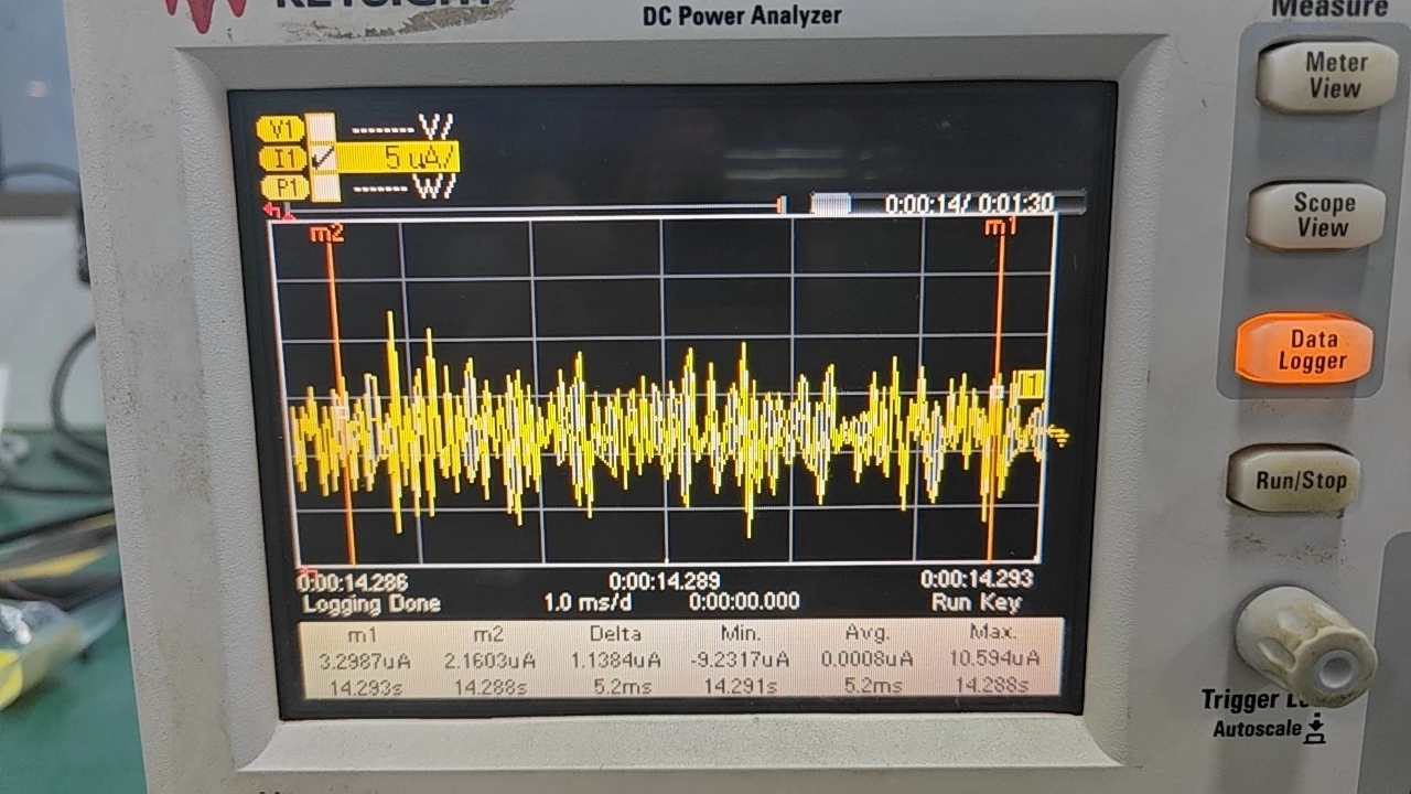

The chip I am using is STM32WB55RGV6. I put it into shutdown mode and tested its current. I am using instrument room N6705C for power supply, with a voltage set to 3.3V for testing. The test result is an average current chamber of a few nA, but the waveform of the current is fluctuating, and the maximum current will look like 5uA. Is this normal?What should the current waveform look like in a normal shutdown mode?
It can be confirmed that there are basically no external connections to the IO port, and they are all configured in analog mode. I am using an inductor of 2.2uH.

I think this is due to the noise coming from the power supplier.

You think is the noise which is form the power supplier, can you provide a specific introduction.I have tested the nucleu board MB1355D which has this issue also.

Could you try using a power supply with a very reduced Noise. I think that should solve the issue.
