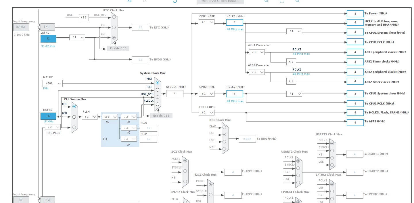

CLK config:

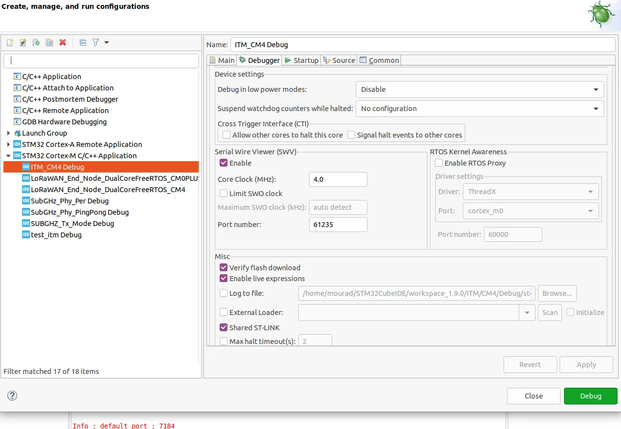

0693W00000QLe4nQAD.pngdebug config:

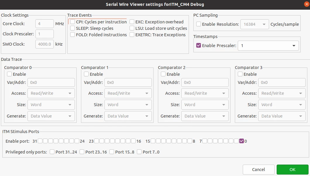

0693W00000QLe6AQAT.pngSWV settings:
0693W00000QLe6jQAD.pngand i click on the red button after that

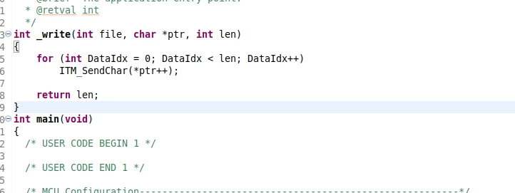

CODE:
override write function:
0693W00000QLe5MQAT.pngand then printf in main function
0693W00000QLe5qQAD.pngAnd ITM_sendchar(*ptr) is being executed, but no printf ouput in console.
also i checked with the oscilloscope the signals while debugging : I can see that SWDIO and SWCLK toggle and SWO is at 3.3V
mboua.1
mboua.1Best answer
Jul 21, 2022 8:19 AM UTC
Solved:
I have soldered the wrong bridge (SB6 instead of SB8) that means SWO not connected to STlink
