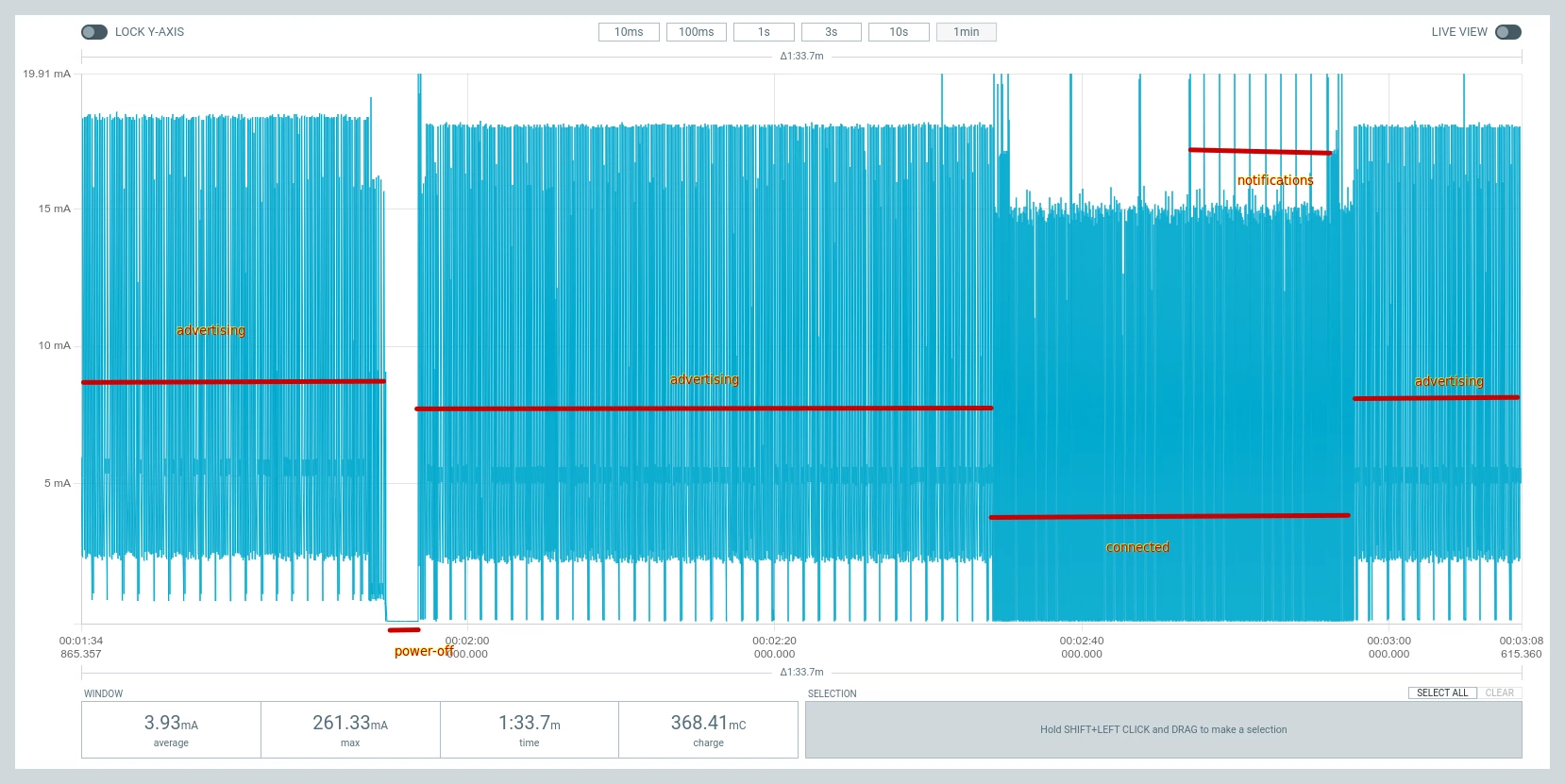

Strange power consumption on advertising with WB55RG with zephyr
We noted a strange consumption pattern regarding the BLE usage w/ zephyr 3.4.0. The BLE stack is the version 1.16.0 (we got the same values w/ 1.17.0 on BLE stack and zephyr hal_stm32 (d466dc8421ee0c6592bb5682aa93a671bc948107)).

The facts:
- zephyr-full.png: advertsing, power-off (removed the JP2), then adverstising, a connection (with notification), and disconnection (hence advertising)

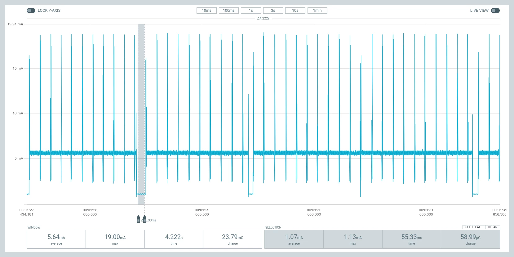

- zephyr-adv.png: advertising after power-off, i.e.: we can see 1s interval between reaching a low-level of

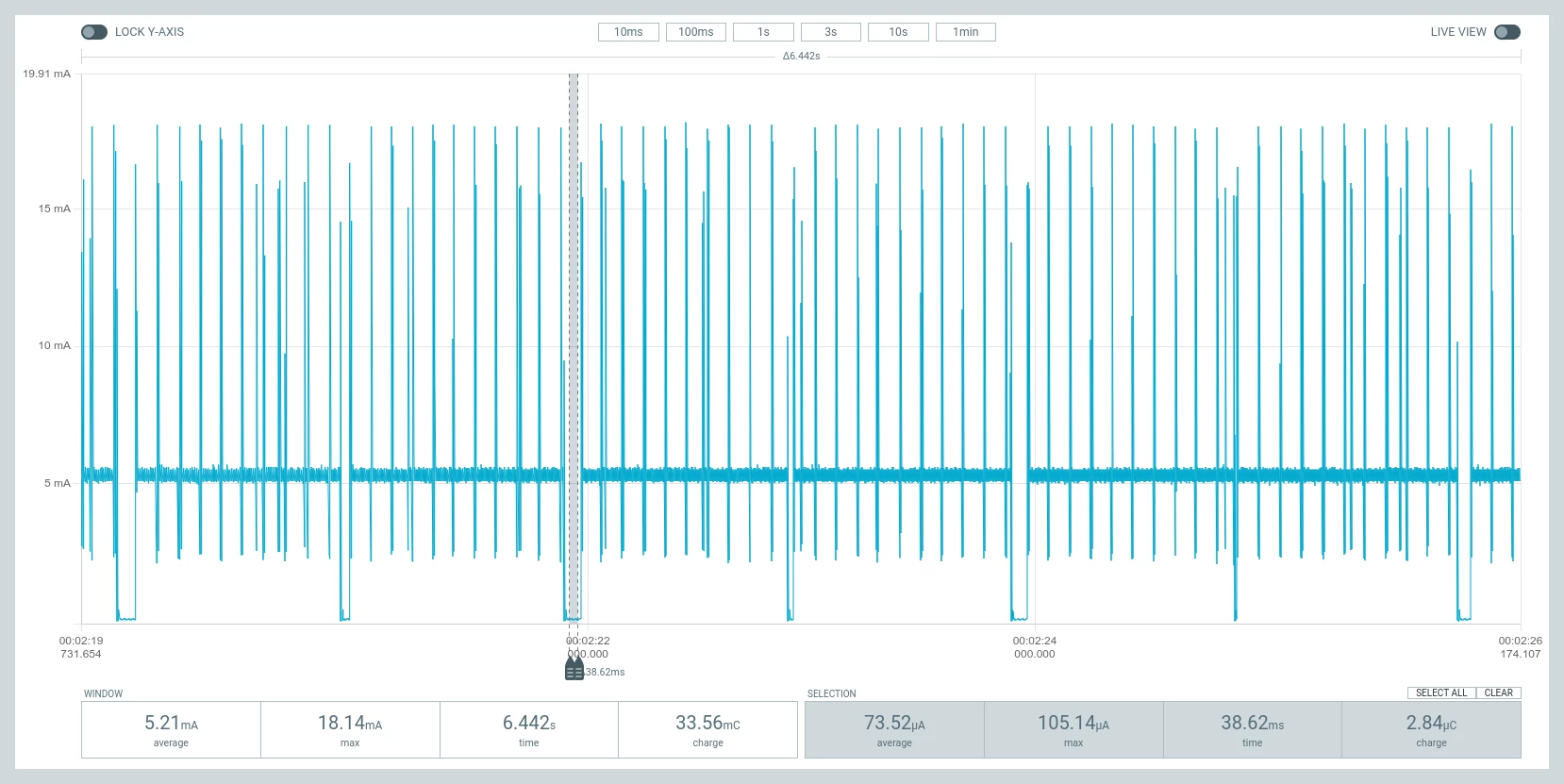

- zephyr-adv-low.png: a low-power consumption during advertising: ~100µA (after a 1s interval)

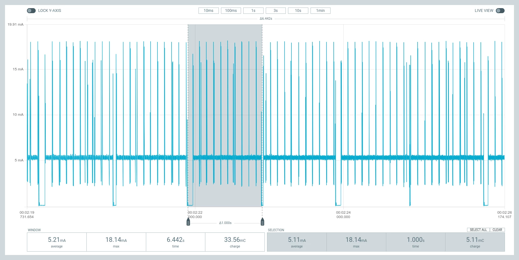

- zephyr-cnx-low.png: the same low-power consumption (~100µA) during connected phase, and the fact that this level is more often reached

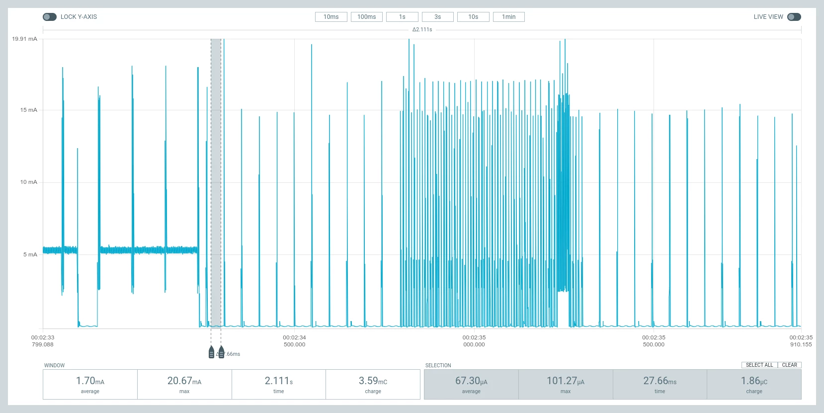

- zephyr-early-adv-low.png: shows a 1mA offset for low-power "more" during advertising

The questions:
- a) why a power-off seems to be needed to reach a real low-power value (a reset does not change the consumption) ?
- b) more importantly: why does the advertising phase does not show the same low-power phases as during the connection ?
Thanks for any help,
Marc.
