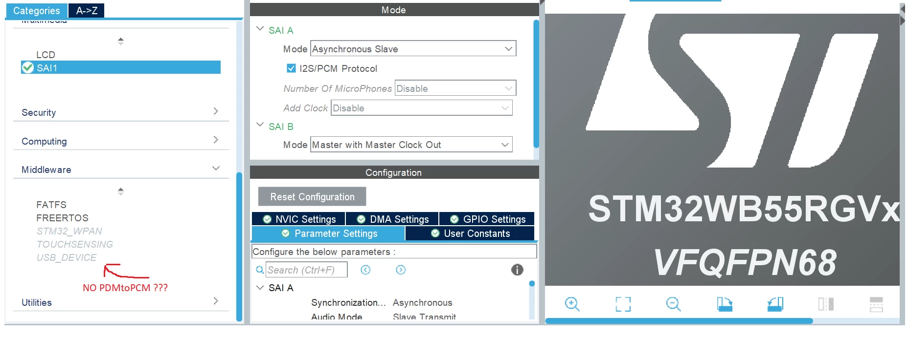

STMCUBE is missing the middleware PDMtoPCM lib for STM32WB55
I find that STMCUBE is missing the middleware PDMtoPCM lib for STM32WB55, see attached.
 How do I get the PDNtoPCM lib and install it in CUBE ?
Thanks Brian

Hello @BFlin.1​
Based on UM2372 the STM32Cube PDM2PCM software library is supported on  STM32F4/F7/H7 Series
You could check this LINK for more details .
Thx
Ghofrane
