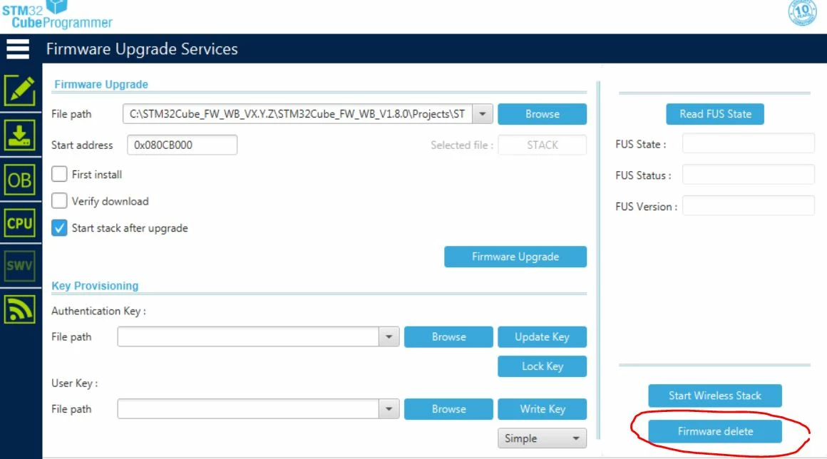

​You have to use the CubeProgrammer V2.5 and click on the "Firmware delete" button.
As I wrote I managed to erase the light RF stack and load a full new one from the same V1.8.0 package on my Nucleo board (1MB Flash memory).
Sep 1, 2020 4:29 PM UTC
I use that - not help for me.

​From the chip. Use the CubeProgrammer tool in GUI mode . You can also use the CLI mode.
On the last picture I attached to this thread, you can see a button "read FUS state". It works well when the USB port is used.

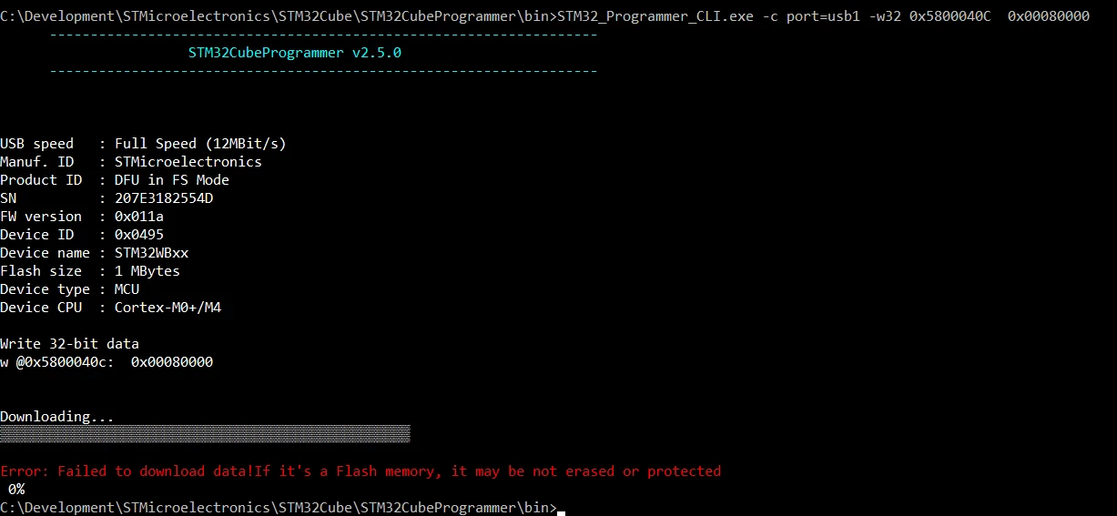

And how to do this: "In last resort we could activate the safe boot which will reset the chip in its manufactory state." ?
Remi QUINTIN
Sep 2, 2020 12:33 PM UTC
​As FUS version is V1.1.0, the revertion to the manufactory state can be achieved writing 0x00080000 at address 0x5800040C.
Sep 2, 2020 12:44 PM UTC
This is a PWR_CR4 ?
And write result is Error
0693W000003QZ1XQAW.png Mey be need to write 0x00008000 (set C2BOOT) ? not 0x00080000.
