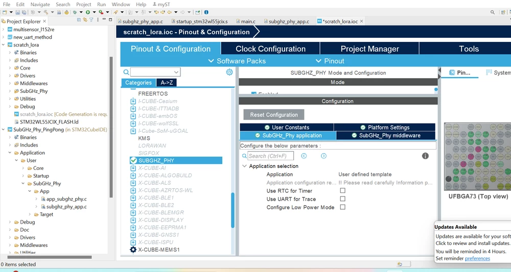

Hi
  I am using the module Lora-E5 which has the STM32WLE5J inside.  Looking at cubeMX , I can select LoraWan, but I want to only use the Lora side. Do I simply select the LoraWan, and use the Lora part, as it requires LoraWan key etc which I wont use.
Best Regards
Scott

Hello @SSmit.13
If you are looking for a P2P communication using the LoRa technologies. You can select the SUBGHZ_PHY middleware on CubeMX :
For more details, refer to the configuration on this example.
Best Regards.

May 26, 2024 3:12 PM UTC
Hi STTwo-32
  Many thanks for your reply. I plan to have many nodes connecting our own hardware (gateway) . The gateway will have 4 hopefully Lora-E5 modules, all communicating at different frequencies, and the nodes connecting to its one of the modules.
The modules have to be lora as we need very low power, and decent distance. Is the above example Lora (even though it says SUBGHZ_PHY)?
Many thanks
Scott
STTwo-32
STTwo-32Best answer
May 26, 2024 3:23 PM UTC
On the examples i've shared with you you can switch to use LoRa or FSK modulations (LoRa is the default one). SubGHz_Phy is the support middleware for those two modulations which use a frequency under 1 GHz (a Sub-GHz frequency ;)).
Best Regards.
STTwo-32
