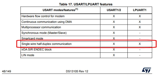

I am trying to enable all 3 UARTS (LPUART, USART1 and USART2) within the STM IDE.
However, on choosing LPUART, USARTS2 become unavailable (and vice versa) .
Is this a device limitation?   We really would like to be able to use all 3 uarts (no flow control necessary)

The STM32WLE5CCUX 48 pin package use the same two Pins (PA2 & PA3) for the TX and RX of the LPUART1 and USART2. So, you can't use them one the same time.

You need to look at the device Datasheet and Reference Manual: they will show you all the available Alternate Function pin allocations - see if any of them works to get access to all 3 UARTs ...

According to the datasheet, they both support single-wire half-duplex:
@DavidG7  - Maybe if you do that, one could use each pin ... ?

On the one wire (Half-duplex) mode, both need to enable the TX pin. this pin is the same for both of them (PA2).
