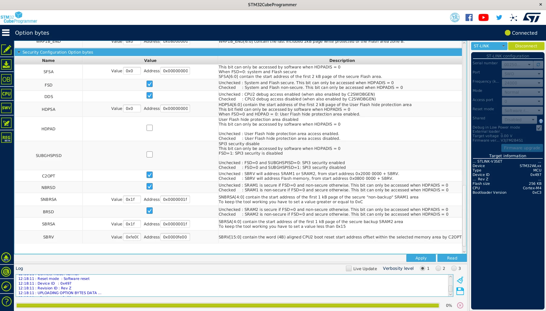

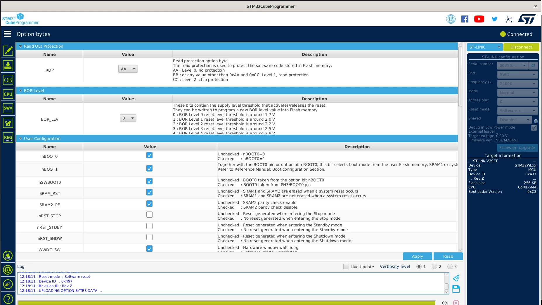

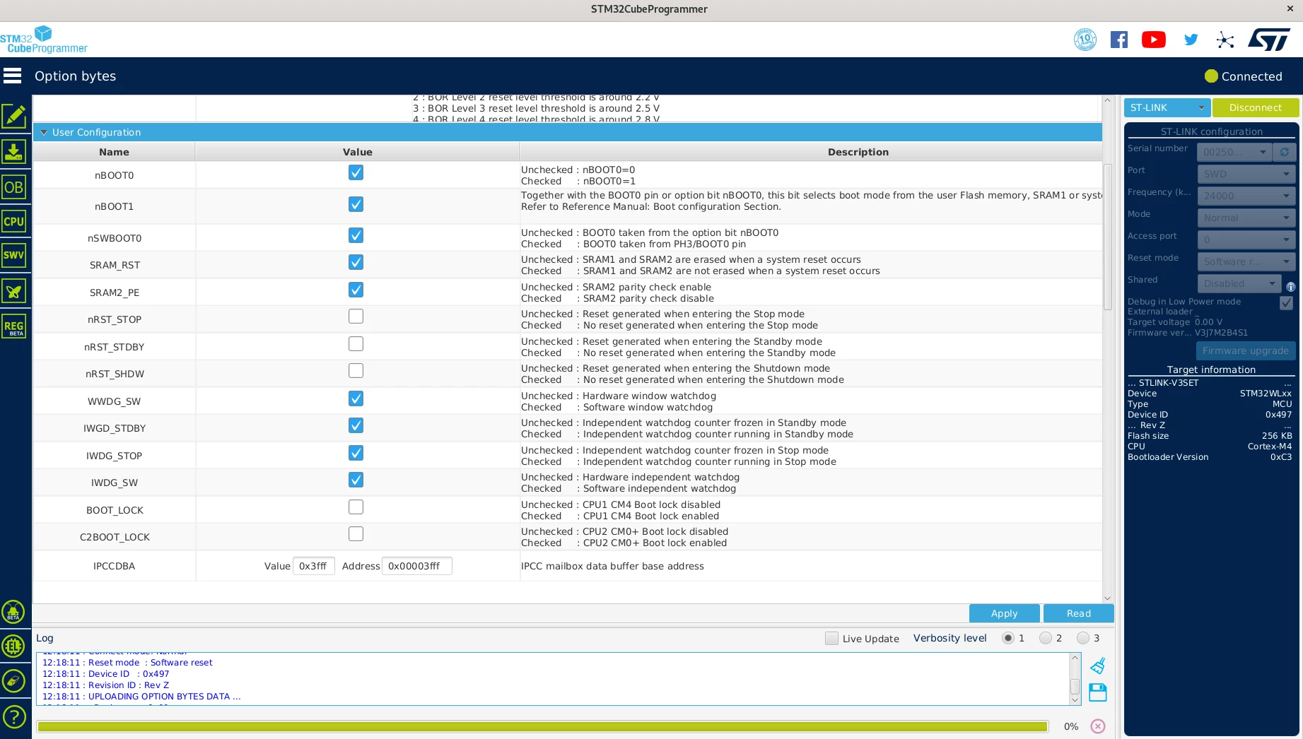

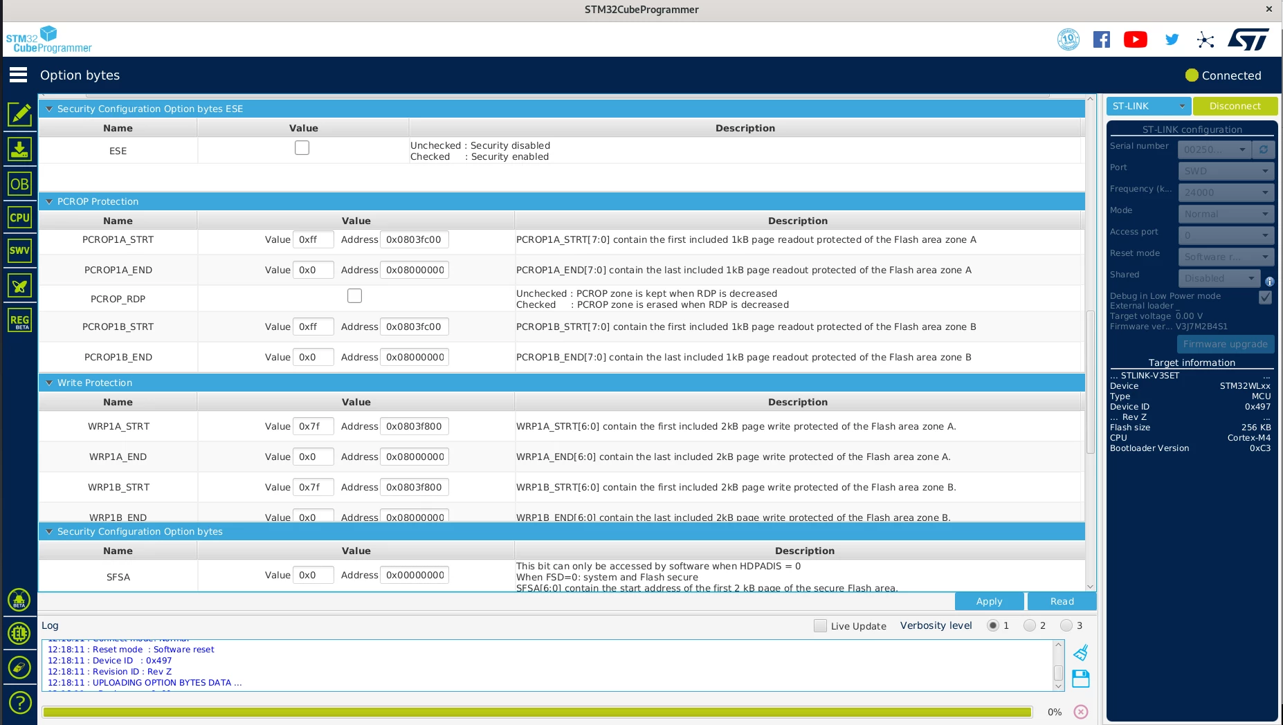

Edit: just in case they might be needed, i attach images of the Option Bytes read from the ST-LINK

When looking at the option bits in a working configuration (ie: the BOR level is already set to 4 and so the code never reaches unlock or launch, they are as follows (as printed by UART and checked by CubeProgrammer)
Value printed to UART->3FFF08AA
RDP: AA
BOR_LEV: 4
ESE: 0
nRST_STOP/STDBY/SHDW: all 0
IWDG_SW/STOP/STDBY: all 1
WWDG_SW: 1
nBOOT1: 1
SRAM_PE/RST: both 1
nSWBOOT0: 1
nBOOT0: 1
BOOT_LOCK: 0
