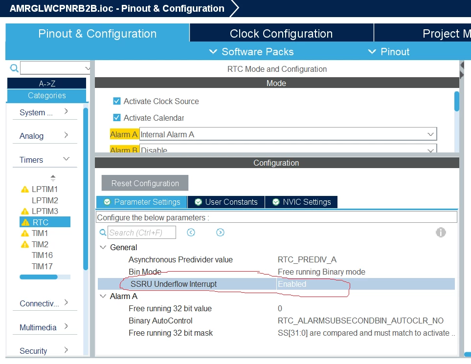

STM32WLE5CC Lorawan get reset when HAL_Gettick() overflows
Our Devices(50 devices) uses STM32WLE5CC and STM32WL V1.0.1 SDK.
I have generated code with Lorawan. All system works perfectly for around 49 days, after that all devices get reboots.
We found that it happens when HAL_Gettick() overflows(we send HAL_Gettick() value to our server on each uplink).
I didn't use HAL_Gettick() function in any other function expect dding this value in lorawan frame , but uses Timer API to create timer and wake device on time.
Please guide us how can I solve this issue?
Currently can't generate issue again as it needs 49 days to overflow HAL_Gettick(). Is there any method I can set HAL_Gettick() time manually so I can be sure about that.

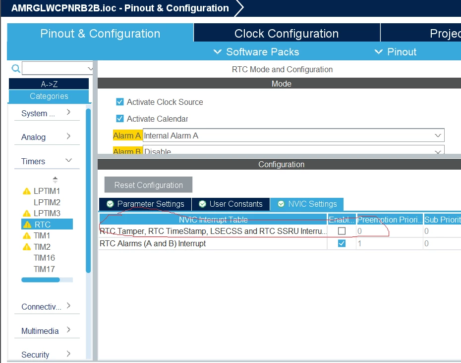

DBhut.1
DBhut.1Best answer
Senior
Sep 13, 2022 8:05 AM UTC
I have not enabled
RTC Tamper, RTC TimeStamp, LSECSS and RTC SSRU Interrupts
Is this can be issue of MCU Reset?

DBhut.1
DBhut.1Author
Senior
Sep 14, 2022 6:10 AM UTC
As Shown in images in 1st one SSRU underflow interrupt is enabled, but
"RTC Tamper, RTC TimeStamp, LSECSS and RTC SSRU Interrupts" is not enabled?
Is this case cause to reset of MCU?
Tesla DeLorean
Guru
Sep 14, 2022 7:57 AM UTC
I don't know, you'll have to walk the code and documentation to understand the mechanics of the failure.​
