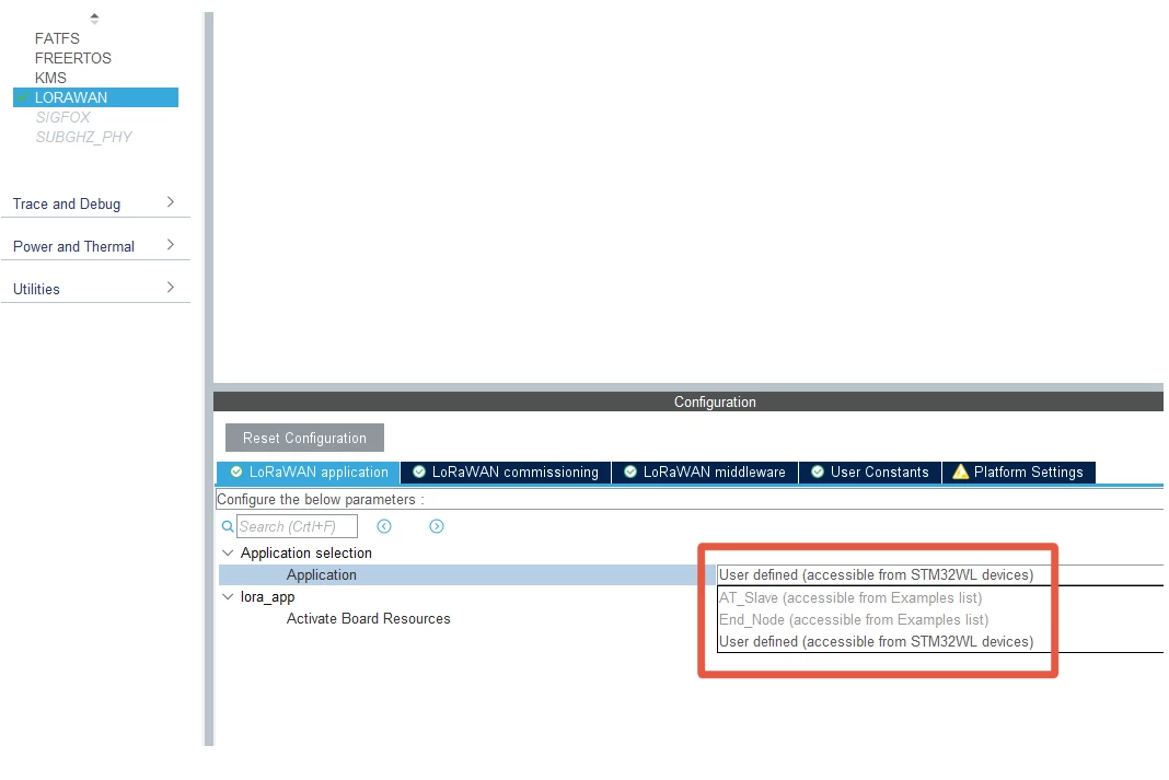

I try to create end_node project for stm32wl5cc uC, but for unkonw reason to me it is impossible
"End_Node" option is inaccessible (grey).
In LoRaWAN_End_Node example it is available.
Ho to do this in Cube Ide.

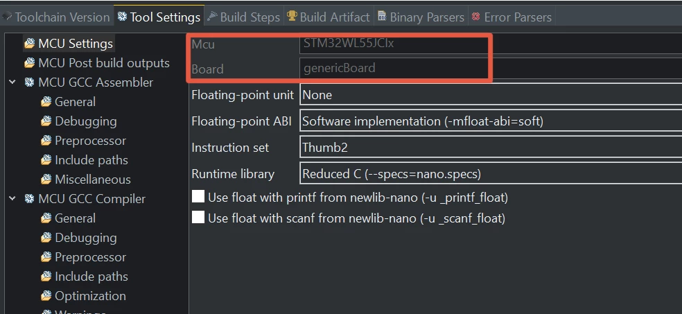

When I try to import project from NUCLEO-WL55JC I can't change uC type to stm32wle5cc
Mcu and Board It's also grey.

not so far. Someone suggest me to take existing one in Nucleo. So I created project for my uC model and just copied from Nucleo what I needed. In this approach cube mx configure soft showing something not related. Partially somethings works. I can't join to tan ;(.
