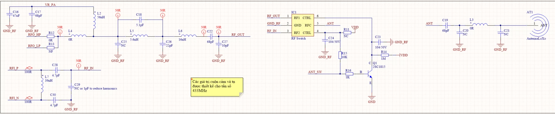

I created Lora project which send and receive data. I designed my board, no TCXO.
My schematic:
0693W00000UFQ6yQAH.pngMy result:

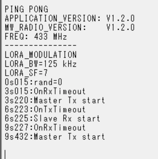

0693W00000UFQ2IQAX.pngthe random value is 0, TxTimeout everytime.
I replaced to new MCU, new RF switch IC but result not change. Please support me.
Thanks.

Did you drop the bandwidth or increase the message size?
I​nterrupts working?
Clock or Timers ticking?
P​erhaps look at how it seeds random

I have the other board the random value is not 0 but the LoRa Tx status is always TxTimeout.
