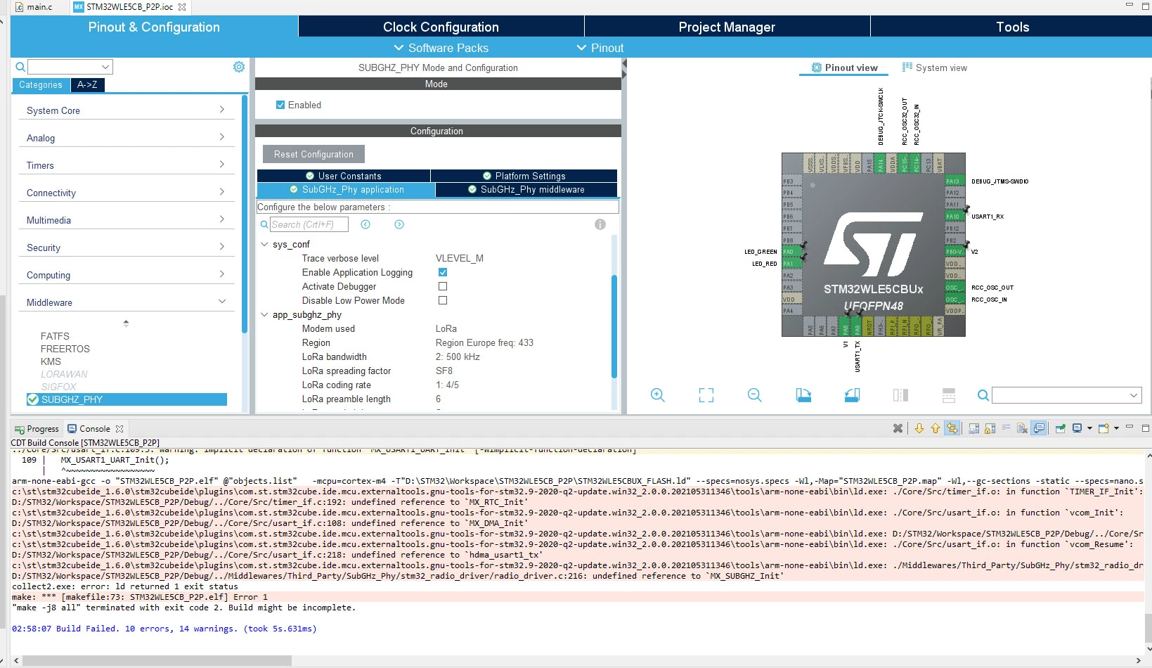

STM32WLE5CB - Simple P2P SubGHz_Phy with custom board impossible?
Hello, coming from a STM32L071 + SX1276 application I find it impossible to achieve the equivalent P2P simplicity using the STM32WL package and the latest version of CubeIDE. Am I correct assuming this package only works with the Nucleo hardware at the moment?
Second question; has anyone managed to get a Simple P2P template working with the STM32WLE5CB on a custom board? Reason I ask this is because I keep getting quite a lot errors no matter what parameters I change, it just never compile. Same for you guys?
Hardware: STM32WLE5CB (GPIO: 2 LEDs, 2 VCTRL for RF TX/RX)
Goal: Board1: TX 1byte + flash led. Board2: RX 1byte + flash led.

Not all impressed by the total lack of engagement. Let's just hope the product is new and not many are using it, yet.
Thank god for crappy weather and Saturdays I've managed to rig a fully functional example for a custom STM32WLE5CB board. Common ultra-low cost; one simple TX/RX switch, and that's it (no TCXO). Attaching an (unofficial) PingPong example made using STM32CubeIDE and FW_WL_V1.1.0 in case anybody needs that. Compiles and works perfectly fine, so it seems.

The silence is worrying. Fair to assume the IDE's existing templates are meant to target Nucleo BGAs & pinouts and yet reached to target custom boards?
Just need a confirmation of that so I can shift the focus back on the STM32L071 + SX1276 application.
Also, when will CubeIDE be geared for custom boards and include templates/examples in their ultimate simplicity?

At this very early stage I'm reaching out to that user-to-user community; asking if you guys managed to get anything to compile out of the templates made available under STM32CubeIDE for a "custom board" with WLE5xx series. Purpose of that is to investigate if custom boards templates are considered (and working?). RE "PingPong" and for all there is to see are half a million headers & source files in the example... this just can't be right and probably explains why nothing really compiles for custom boards... I really don't know what's going on/I'm just asking. For Nucleo only?
Not that I'm stranded or anything like that, STM32L071 + SX1276 rules world-size in terms of simplicity so I'm sticking to this for now. I'd still be interested to see what you guys came up with for P2P nodes in terms of CubeIDE templates anyway. Or at least know when examples from ST are planed to come out would also be a good starting point... if anyone knows.

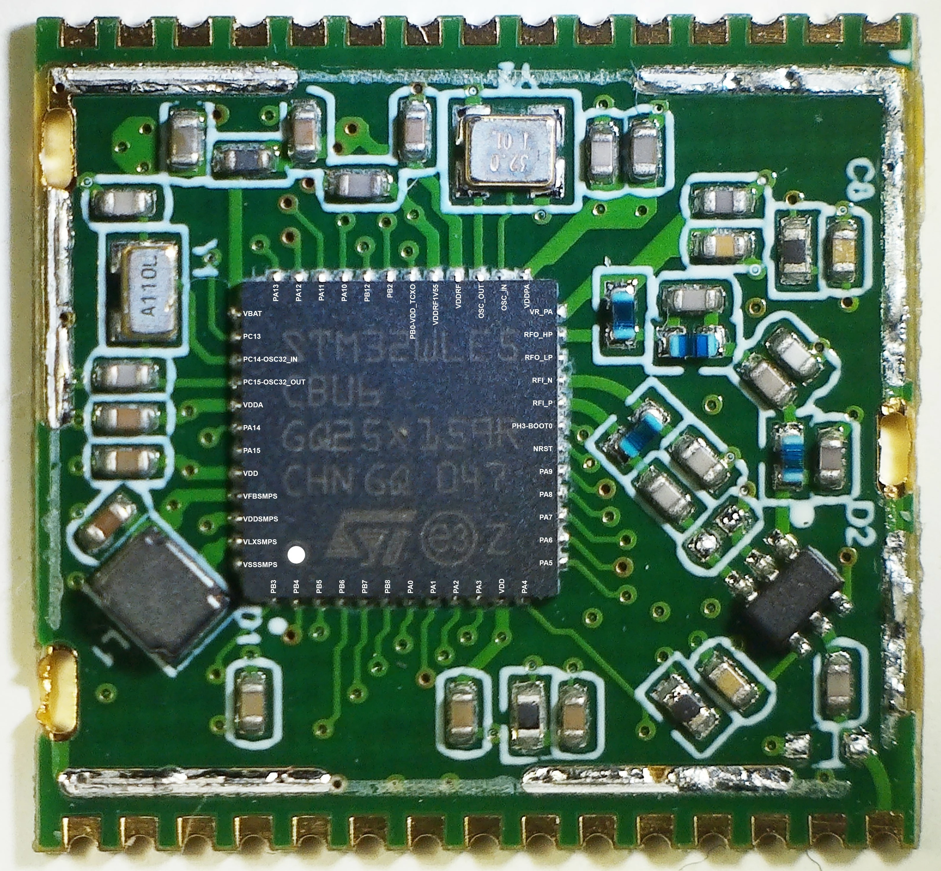

Got some STM32WL DISCO and NUCLEO boards, tinkered with them to a point. Most of this does look rather bloated, so I'm probably going to back-port the SX1262 code I have for other modules into the STM32WLE5
In the near term I'll probably use the Seeed Lora-E5 Module as a cheap/convenient target. The STM32WL is for most purposes an L4 with an SX1262 bolted onto an internalize SPI peripheral connection.
