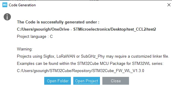

  1. STM32CubeMX told me to change the linker file because "subghz_phy" is active? what is there to change?

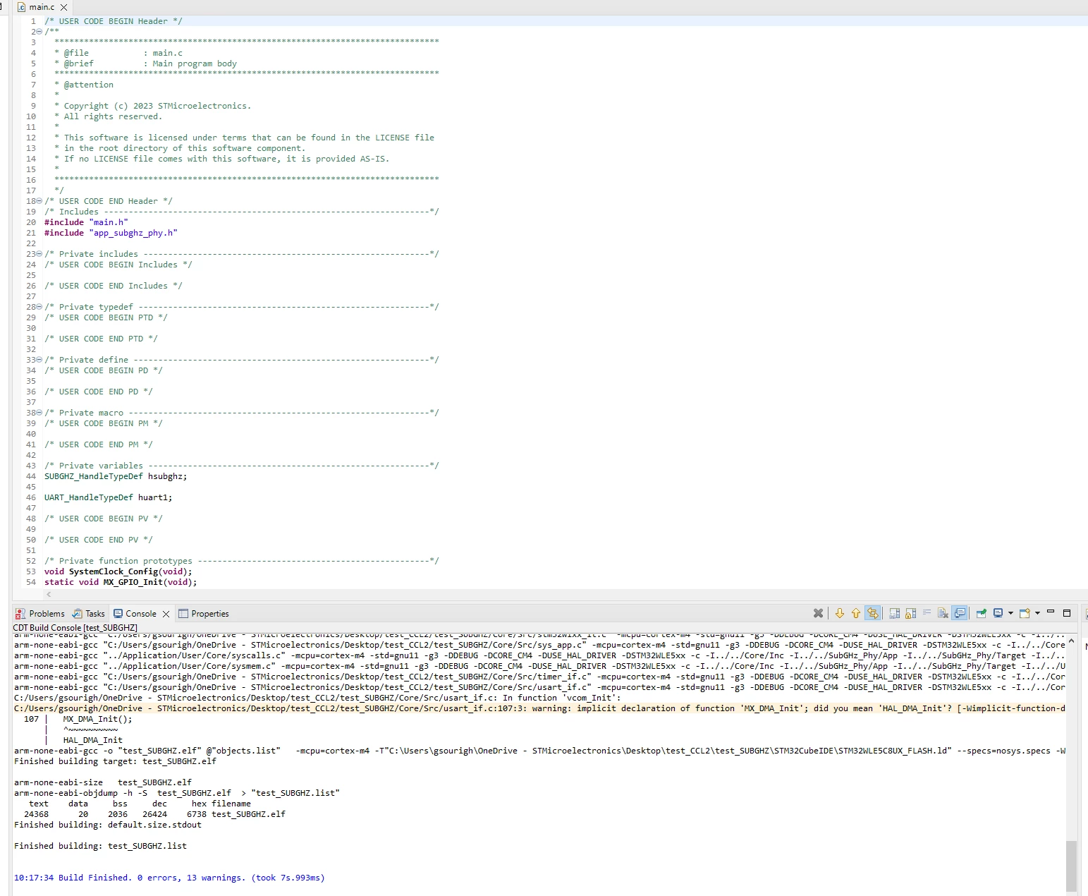

Actually I tried to reproduce the issue mentioned above :
I used the CubeMX 6.8.0 and the STM32WLE5 MCU : I activated the "USART1", "SUBGHZ "and "SUBGHZ_PHY": this is what I got after generate the code
_legacyfs_online_stmicro_images_0693W00000bhiKnQAI.pngAfter building the generated code
You will find below my ioc .
I will be waiting for your feedback to understand more the situation .
Thx

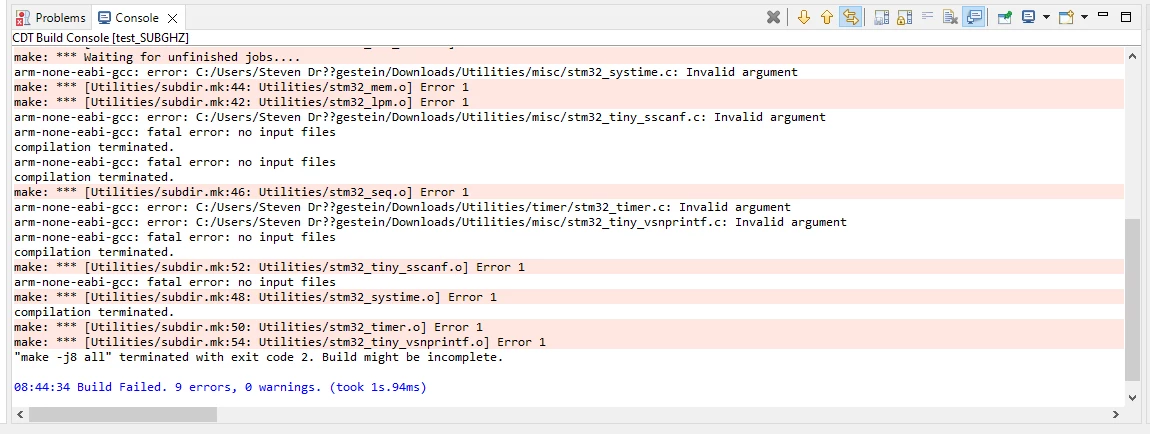

I downloaded your .ioc file, did generate Code with STM32CubeMX and opened the .project File in STM32CubeIDE.
Then i tried to build the project and got 9 Errors, 0 Warnings.
f.e.:
arm-none-eabi-gcc: error: C:/Users/Steven Dr??gestein/Downloads/Utilities/sequencer/stm32_seq.c: Invalid argument
arm-none-eabi-gcc: fatal error: no input files
Its pretty much the same issue like i had in my recent test projects..

Draegi
DraegiAuthor
Apr 11, 2023 8:05 AM UTC
Hello @Ghofrane GSOURI​
I also used Cube IDE 1.12.0
Even if i create a totally new project in the Cube IDE, i get the same Error with the Linker File "STM32WLE5CCUX_FLASH.ld"
No such file or directory.
I will reinstall CubeIDE
