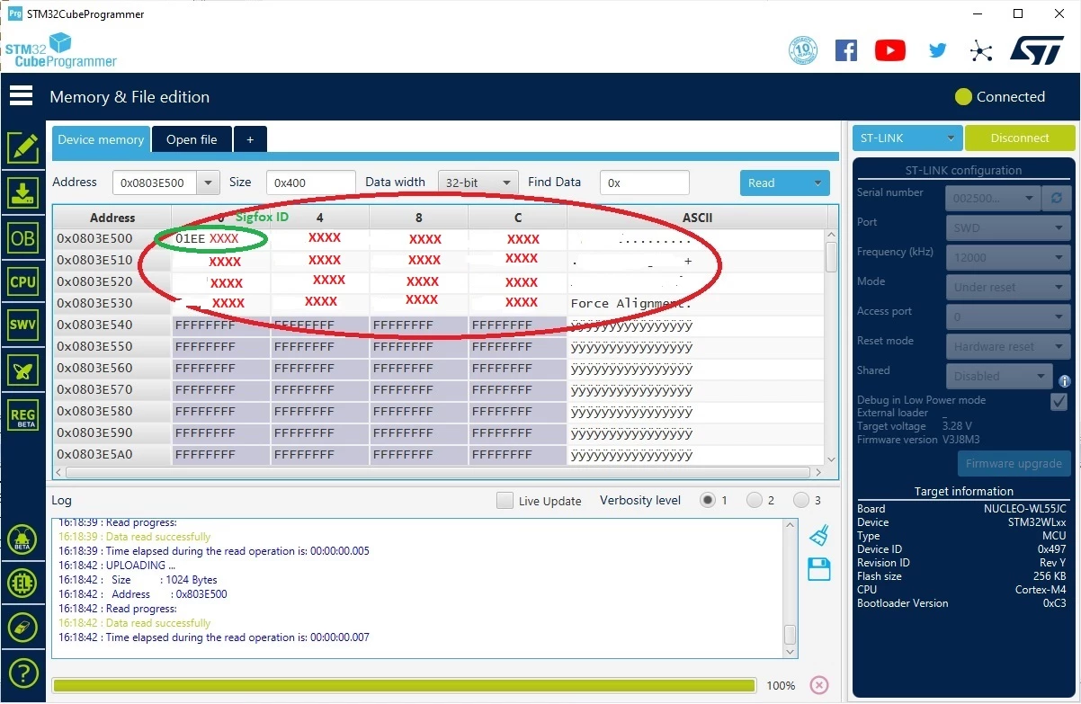

First, with Cube programmer tool, when looking at the location 0x0803E500, do you see the credentials obtained with ST (sigfox PAC and ID )? If not it you can't see your data on Sigfox backend.
To illustrate, I'm sending attached a print screen of location before and after loading the credentials
You should use STM32Cubeprogrammer v2.8.0.
Moreover, what toolchain are you using: STM32CubeIDE, IAR or KEIL?
Finally, you could test if your credentials load sequence is correct with AT_Slave project, opening a terminal and sending "AT$ID=?" command before and after the load of your credentials, checking if the answer is correct.

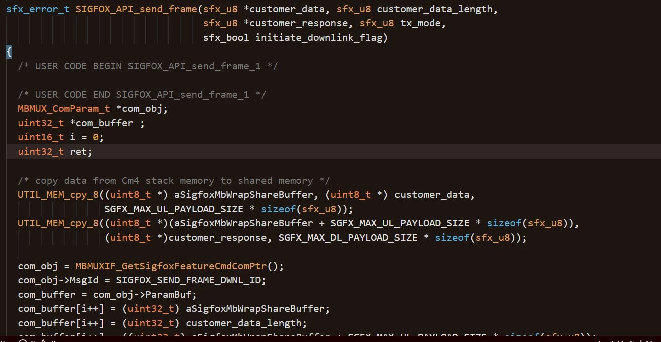

So I tried to run the code but no signal from Sigfox came out. I was confused by not having a prototype like the dual core version has. As shown in the figures below.0693W00000DqDyjQAF.jpg
Here we can see the prototype of the SIGFOX_API_send_frame() function. But this only exists in the dual core example. The single core has no prototype of this function, and I don't see any signal coming out of the board when I run the AT_SLAVE or PUSHBUTTON (SINGLE CORE) example

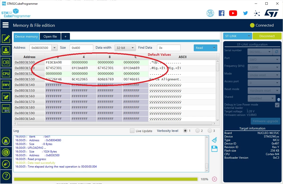

Aug 23, 2021 2:49 PM UTC
Here is the same location before loading credentials, containing default values
