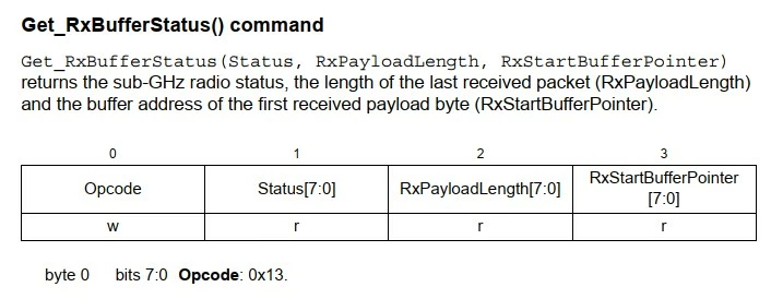

  1. After transmitting data the size of RX buffer is set to size of last transmitted packet. So after transmission of short packet I receive only half of expected data. As I understood both buffers (RX and TX) are separated and can be configured independently. Is it something that needs to be configured every time I switch module to RX mode?
  2. Implementation of command Get_RxBufferStatus() (0x13) seems to be different than showed in manual. In the example code (and in the working device) I can't receive status byte showed in the manual. Is it bug/manual mistake or am I missing something?
void SUBGRF_GetRxBufferStatus( uint8_t *payloadLength, uint8_t *rxStartBufferPointer )
 uint8_t status[2];
	if(SUBGRF_ReadCommand( RADIO_GET_RXBUFFERSTATUS, status, 2 ) == HAL_OK)
 // In case of LORA fixed header, the payloadLength is obtained by reading
 // the register REG_LR_PAYLOADLENGTH
 if( ( SUBGRF_GetPacketType( ) == PACKET_TYPE_LORA ) && ( LoRaHeaderType == LORA_PACKET_FIXED_LENGTH ) )
 *payloadLength = SUBGRF_ReadRegister( REG_LR_PAYLOADLENGTH );
 else
 *payloadLength = status[0];
 *rxStartBufferPointer = status[1];
I will be grateful for any help!
