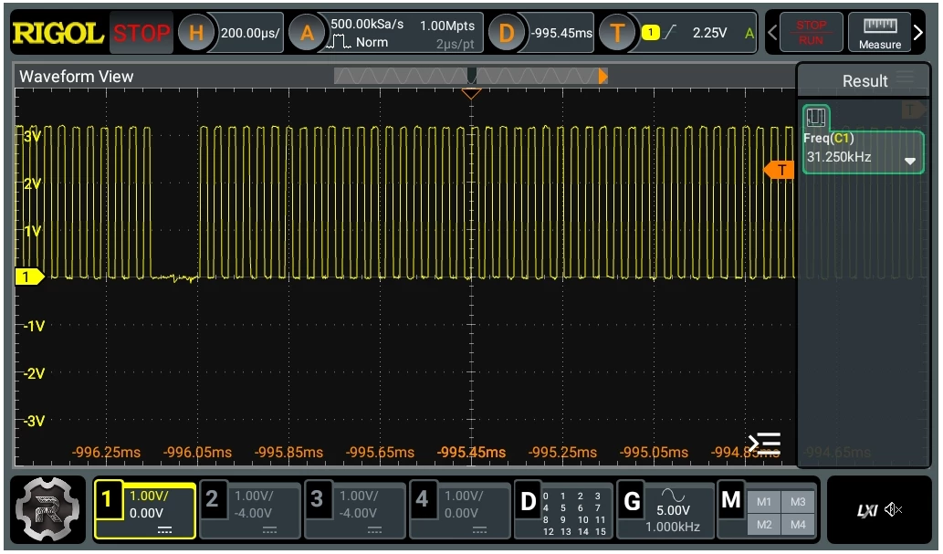

I am working with STM32WLE5CC and using the LSCO output
(configured via HAL_RCCEx_EnableLSCO(RCC_LSCOSOURCE_LSI), source = LSI)
to observe the low‑speed clock externally.
In my application:
  • LSI is used as the RTC clock source
  • RTC is used as the wake‑up source from Stop2 mode
  • RTC is configured in binary‑only mode
  • AsynchPrediv = 30
  • Wake‑up period = 5 seconds
According to RM0461:
  • “The clock on LSCO is available in Run, Stop, Standby and Shutdown modes.”
  • “In Stop 2 mode, all I/O pins keep the same state as in the Run mode.”
This observation is independent of RF RX/TX activity and refers only to the Run ↔ Stop2 transition.

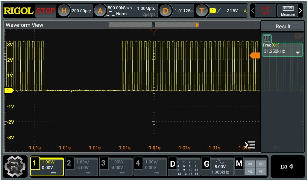

However, on hardware I observe the following behavior:
  • When transitioning from Run → Stop2, the LSCO pin stops toggling for a short time (~104 µs), then resumes.
  • When transitioning from Stop2 → Run, the LSCO pin stops toggling for a longer time (~530 µs) before toggling again.
This occurs even though:
  • LSCO is enabled
  • LSI remains enabled
  • RTC wake‑up from Stop2 works correctly
  • GPIO configuration is unchanged
Once the device is fully in Run or Stop2 steady state, LSCO toggles correctly.

Hello @Masud ,
There is no specific behavior about LSCO pin during low-power mode transitions.
You might find help in the section "2 Power modes" in the AN5568 Application note Ultra-low-power features of STM32WL5x/Ex microcontrollers.
In addition, this presentation STM32WL5-System-Power control (PWR) covers the power modes for STM32WL5.

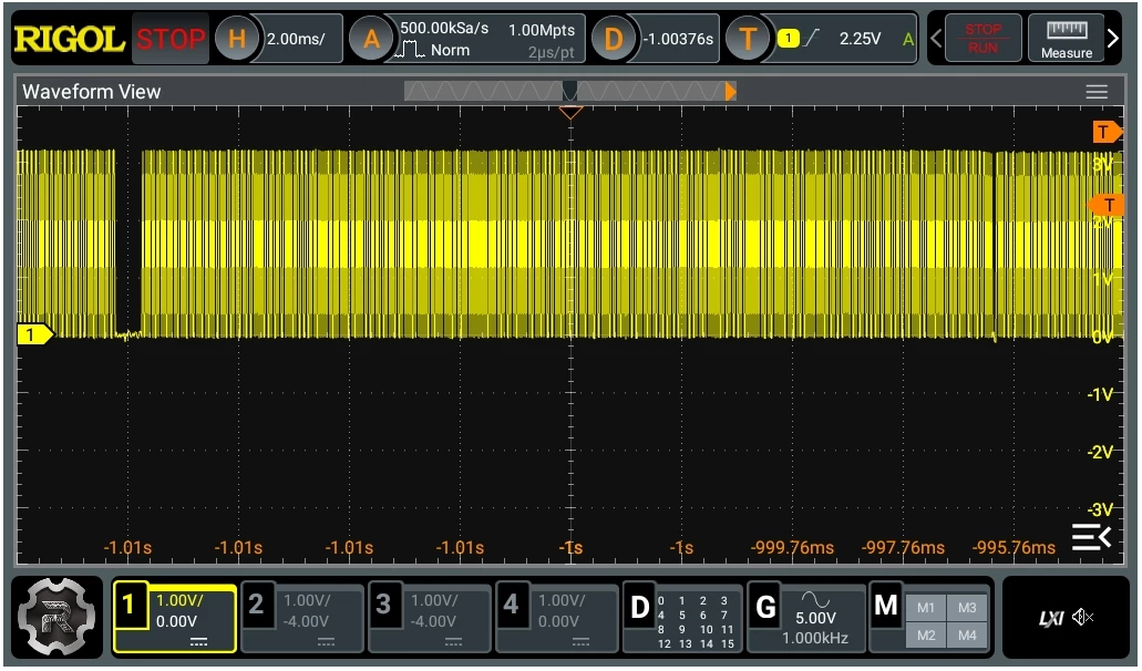

I am attaching my observation result for the proof.
Please provide me the answers for this so that I can justify the behavior
