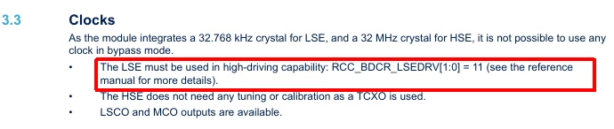

Which LSE drive level do you use?
Aug 4, 2026 6:01 PM UTC
Hi JW,
I’m using the high drive as per the documentation RCC_LSEDRIVE_HIGH.

/** Configure LSE Drive Capability
* High drive capability (LSEDRV[1:0] = 11) per ST guidance, given the
* on-board SubGHz radio's RF activity is a plausible noise source for a
* low-drive 32.768kHz oscillator sharing the same board.
HAL_PWR_EnableBkUpAccess();
__HAL_RCC_LSEDRIVE_CONFIG(RCC_LSEDRIVE_HIGH);

Aug 7, 2026 8:03 PM UTC
Hi Filippo,
I already tried the calibration and this gave me good results.
According to the specs, I should have ~20ppm, not ~100ppm.
Is the 20ppm achievable just with calibration?
Thanks,
Alex
