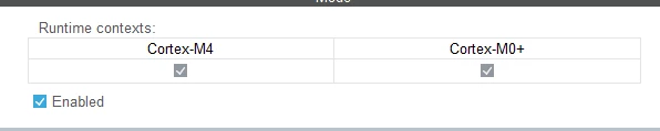

Jan 26, 2024 2:43 PM UTC
Hi again,
i try to create a lorawan project working on single core. can i use M0plus core for lorawan project and M4 core for general purpose. when i try to create new project, cubemx use both core for lorawan. how can i disable cortex-M4 core shown as below image
STTwo-32
Jan 26, 2024 3:40 PM UTC
The LORAWAN middleware need to be activated on both contexts "Cortex-M4 and Cortex-M0+" for Dual core  projects.
Best Regards.
