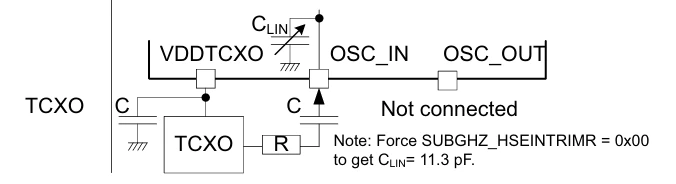

I am on the STM32WL55CCUX and am facing an issue with both the SubGHz radio initialization and the external 32 MHz TCXO/HSE32 clock.
I have a working STM32WL55JC1 board for comparison. The same/general SubGHz software flow works correctly on the JC1, whereas the custom CCUX board exhibits the following two problems:
  1. The SubGHz radio remains permanently/continuously in the RF BUSY state.
  2. The external 32 MHz, 3.3 V TCXO is not being powered through PB0/VDDTCXO, and HSERDY does not become active.
I would like ST's assistance in determining whether these two symptoms are related to the RF power/reset/TCXO sequencing, a CCUX-specific requirement, or a hardware/configuration issue.
This is the current analysis so far
                         JC1             CCUX
PB0/TCXO supply           Active          0 V
HSERDY                    1               0
ErrorCode                 0               0x02
RFBUSYS after init        0               1
STDBY_RC                  PASS            FAIL

Hi dilipraj1709,
you need to figure out why the PB0 is at 0 V: firmware issue or schematic issue.

Thanks for your feedback, since the board is different, any schematics is different about TCXO design as well as related layout about the TCXO? It is an external crystal for 32MHz.
Oct 8, 2026 9:15 AM UTC
Hi dilipraj1709,
to me it is strange that the very same software is working in the Nucleo and not in your custom board, at least for one point: the value of PB0 voltage. Before even thinking to the causes for the TCXO not to start, I am wondering how it is possible that PB0 voltage is stuck at 0 V in your custom board and not in the Nucleo.
The software must initialize PB0 as an output pin. Otherwise, the STM32 Nucleo board cannot operate. Can this be confirmed?

Hi ​@Filippo_Malleo,
In my custom board, when I make PB0 as an output GPIO, I am able to see 3.3V, but when I configure the PB0 as the VDDTCXO, I am not able to see the PB0 getting high. We used the WL55 Evaluation board and used the JC1 package as reference to design the STM32WL55CCUx board.
Oct 12, 2026 1:07 PM UTC
Hi, dilipraj1709,
so, you configure PB0 in analog mode, enable VDDTCXO supply but you read 0 V instead of 3.3 V? If you remove the TXCO component from the board, you still get 0 V or 3.3 V?
Oct 13, 2026 10:19 AM UTC
Hi ​@Filippo_Malleo.
I understand from the STM32WL55 document that PB0 can be configured as VDDTCXO or an Analog output pin.
When we configure the PB0 as VDD TCXO, it is directly controlled by the internal hardware step-down Switch-Mode Power Supply (SMPS) or low-dropout (LDO) radio sub-system controllers to scale and output a clean, programmable voltage range required by the external 32 MHz crystal oscillator.
My question here is since this is an internal process, when I currently configure the STM32WL55CCUx with PB0 as VDDTCXO, I am not seeing any supply from the PB0 pin.
But when I configure PB0 as a Analog GPIO output, I am seeing the supply voltage of 3.3V

Hello dilipraj1709,
I suggest you to complete the SubGHz SPI initialization, then you can change the register settings. For example, I used this code to change the PB0 voltage:
static void MX_SUBGHZ_Init(void)
  /* USER CODE BEGIN SUBGHZ_Init 0 */
  /* USER CODE END SUBGHZ_Init 0 */
  /* USER CODE BEGIN SUBGHZ_Init 1 */
  /* USER CODE END SUBGHZ_Init 1 */
  hsubghz.Init.BaudratePrescaler = SUBGHZSPI_BAUDRATEPRESCALER_8;
  if (HAL_SUBGHZ_Init(&hsubghz) != HAL_OK)
    Error_Handler();
  /* USER CODE BEGIN SUBGHZ_Init 2 */
  SUBGRF_SetTcxoMode(TCXO_CTRL_3_3V, 0);
  LL_RCC_HSE_EnableTcxo();
  LL_RCC_HSE_Enable();
and I removed the HSE part from the following function:
void HAL_SUBGHZ_MspInit(SUBGHZ_HandleTypeDef* hsubghz)
    /* USER CODE BEGIN SUBGHZ_MspInit 0 */
    /* USER CODE END SUBGHZ_MspInit 0 */
    /* Peripheral clock enable */
    __HAL_RCC_SUBGHZSPI_CLK_ENABLE();
    /* USER CODE BEGIN SUBGHZ_MspInit 1 */
  //LL_RCC_HSE_EnableTcxo();
  //LL_RCC_HSE_Enable();
//  while (LL_RCC_HSE_IsReady() == 0)
    /* USER CODE END SUBGHZ_MspInit 1 */
Also pay attention to the note in the Reference Manual:
1. To use VDDTCXO, the VDDRF supply must be at least + 200 mV higher than the selected RegTcxoTrim voltage level.
at the Table 40. RegTcxoTrim and Timeout bytes definition.
In the Nucleo board I saw that the TCXO starts with the default voltage of 1.75 V and after the init I am able to change this voltage.
In your custom board I saw from the part number that your TCXO requires 3.3V so it cannot start with 1.74 V I guess.

Filippo_MalleoBest answer
Oct 20, 2026 4:12 PM UTC
Hello dilipraj1709,
let me add that in the function that you used, the same that can be found in the SubGHz_Phy_Per example of the SDK,
it works just changing the TCXO_CTRL_VOLTAGE value:
// Initialize TCXO control
    if (1U == RBI_IsTCXO() )
        SUBGRF_SetTcxoMode( TCXO_CTRL_VOLTAGE, RF_WAKEUP_TIME << 6 );// 100 ms
        SUBGRF_WriteRegister( REG_XTA_TRIM, 0x00 );
        /*enable calibration for cut1.1 and later*/
        CalibrationParams_t calibParam;
        calibParam.Value = 0x7F;
        SUBGRF_Calibrate( calibParam );
no need to add more code, HSEBYPPWR is already 1.
So, again, I suggest you to double-check the PB0 voltage in a radio state that requires the crystal to be active: MODE_STDBY_XOSC, MODE_FS, MODE_TX, MODE_RX.
