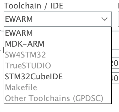

STM32WL55: Why is Makefile grayed out in STM32CubeMX?
I'm trying to create a Makefile-based project for the STM32WL55CCUx microcontroller but it's not possible.
Why is it disabled? Is there a workaround?

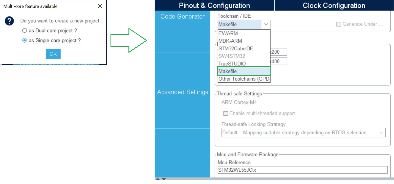

Actually Makefile toolchain (as well as TrueSTUDIO and GPDSC) are not available for multicontext SOCS.
Otherwise, starting the project based on STM32WL55 as Single Core, it will be possible to select Makefile as toolchain :
0693W00000AOswvQAD.pngHope this answers your question. If it is the case, please click on the Select as Best button on my reply in order to help other members of the community find the answer more quickly.
