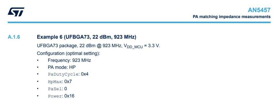

I need to design a custom board for LoRa 923MHz network.
The AN5457 provides the example for 923MHz network. (A.1.6)

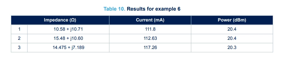

0693W00000KdUa7QAF.png0693W00000KdUZxQAN.pngI can get output Impedance from this example(AN5457).
But I can't find LNA (Differential) Input Impedance for UFBGA73 package @923MHz.
Could you please give me input Impedance data of this package and this frequency?

Hello, the differential input impedance to present to the LNA is Zdiff_opt=60+j*125.
