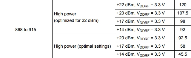

I am working on STM32WL55 dual core in which the current consumption is as not as expected as according to the datasheet. It is hardcoded for high power only. and the current consumption is coming for +17dBm and +14dBm as expected which is 58mA and 45mA approax but when switching to the +20dBm and +22dBm it is getting capped at 68mA only. It is not going above 68mA at any way. I have hardcoded it to 22dBm but it is still getting capped to 68mA only. I want to do changes in the code in such a way that the current consumption changes. what are the possible reasons of it and what are the functions where the code modification can help in changing the current consumption. Is there that ST has capped it to +18dBm or +17dBM  and will never work above it?

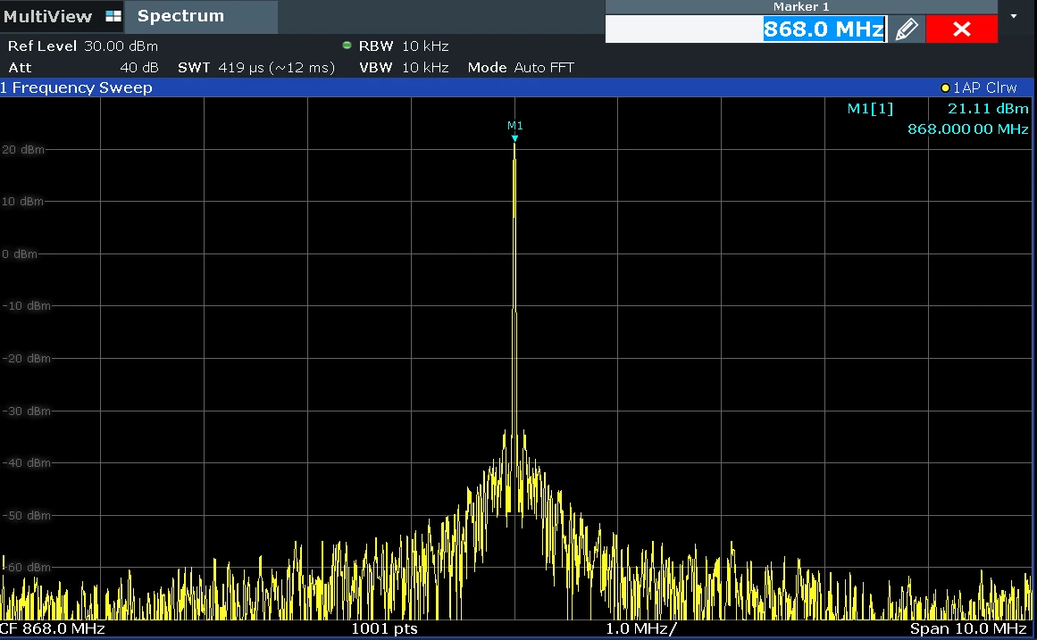

Hi Somya,
using a MB1389E Nucleo Board and LoRaWAN_AT_Slave Application Example, you can get around 21 dBm. If you want to get +22 dBm I suggest you double checking the BOM you are using.
Here are the AT command I used for the test (I set the US band and not the EU to reach that power):
AT+TCONF=868000000:22:50000:50000:4/5:0:0:0:16:25000:2:3
OK
AT+TCONF=?
1: Freq= 868000000 Hz
2: Power= 22 dBm
3: Bandwidth= 50000 Hz
4: FSK datarate= 50000 bps
5: Coding Rate not applicable
6: LNA State= 0
7: PA Boost State= 0
8: modulation FSK
9: Payload len= 16 Bytes
10: FSK deviation= 25000 Hz
11: LowDRopt not applicable
12: FSK gaussian BT product= 3
OK
AT+TTONE
363s378:Tx FSK Test
AT+BAND=?
8:US915
BR,
