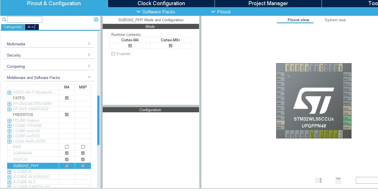

Dear all!
I'm working with a custom board. I would like to make a simple application (without Lora). Just sending packets that the device receives from Uart over the air to another device. 1st approch will be only in one direction to keep it simple.
Some entries unter middleware are selected and grayed out.
Middleware-SubGHZPHY: It is selected, grayed out. I can't configure anything and there is no 'middleware' folder/code in the generated code. Do I have to add the code manually?
Middleware-Freertos: It is selected, grayed out.  I can't configure anything and the code doesn't look like rtos (no threads and so on.
FYI: I have activated SUBGHZ.
Does anybody know a simple example/tutorial, how to start with an simple application, that sends packets from one device to the other device?

Ok! I played a lot with STM32CubeIDE before my post...and after posting my issues I found the solution. The main important thing is to read the "messages" from STM32CubeIDE, when hoovering over a checkbox :)
-) Middleware-SubGHZPHY can only be activated, if Lorawan and Sigfox are not enabled. But IPCC must be activated.
-) FreeRtos. I have to enable it and the I can choose between CMSIS 1 / CMSIS 2
I would be happy about an example as mentioned above - or something similar.

Happy you have solved your issue. For the examples, i suggest you to refer to the ping_pong examples on this link. You can also use this Local network communication demo and refer to this tutorial for more details.
