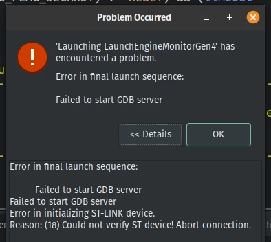

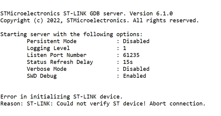

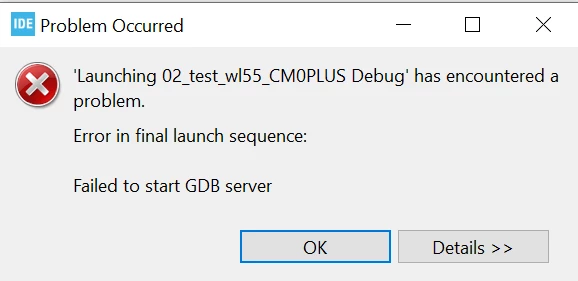

STM32WL55 dual core debug _ error 18 when debugging CM0+
I have started to use stm32wl55 nucleo.
I try to debug a basic application.
I start by debugging CPU1 (CM4) than after booting CPU2 (CM0+) i run the debug for the second CPU.
But ST-LINK: Could not verify ST device!
error details :
Error in final launch sequence:
Failed to start GDB server
Error in initializing ST-LINK device.
Reason: (18) Could not verify ST device! Abort connection.
Any suggestion ?
Thank's.

Yes, unfortunately a regression bug has been confirmed with respect to debugging of STM32WL Cortex-M0+ core in STM32CubeIDE 1.9.0 vs previous versions.
  • Short-term: The few number of users affected are advised to use STM32CubeIDE 1.8.0 which contains a matching feature set with respect to STM32WL development.
  • Long-term: The final fix will be delivered in the next STM32CubeIDE version.
Sorry for the inconvenience!

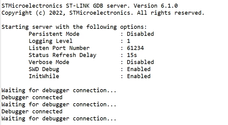

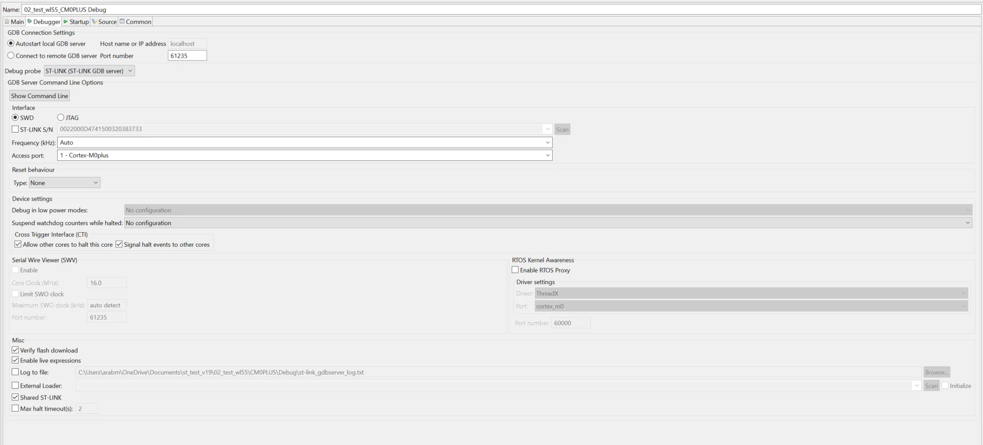

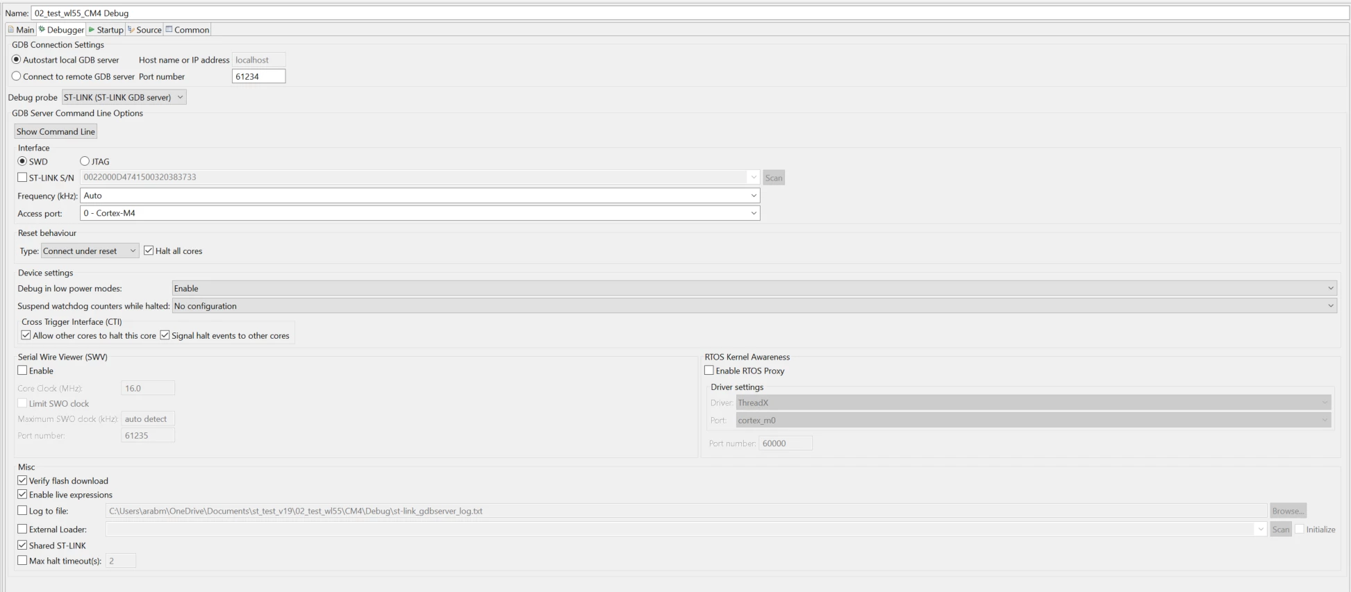

here is my debug config :
CM0P :
0693W00000KcGyxQAF.pngCM4 :
LaurentL
Mar 11, 2022 4:03 PM UTC
The debug configs look good.
Maybe add one to the port on CM0+ debug config.
But you should download CM0+ application code with the CM4 core.
To do that, go to the startup tab (of CM4 debug) and add the CM0+ elf download.
And In the CM0+ startup tab, select the elf and edit to remove the download (keep the load symbols).
Rgds,
Laurent
