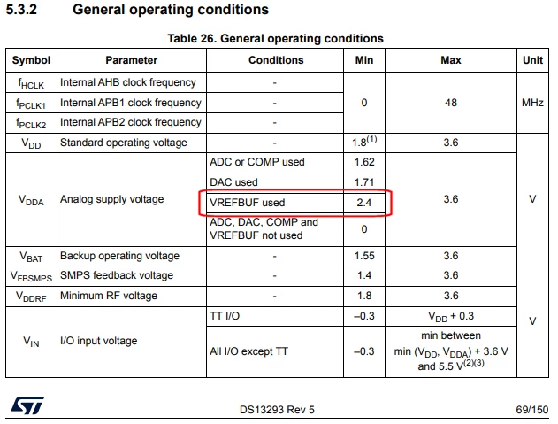

I am working on a LoRa application with the STM32WL5MOC module which features the STM32WL55JC microcontroller. According to the datasheet, this module is compatible with a voltage level as low as 1.8V.
I am using the STM32CubeWL MCU Package for the firmware, and I have configured the Low Power (LP) mode for a 14dBm transmission power. However, the board stops functioning whenever the voltage drops below 2.05V.
Has anyone encountered a similar issue or have any suggestions on how to address this?

@SMav wrote:
the board stops functioning whenever the voltage drops below 2.05V.!
What, exactly, do you mean by "stops functioning" ?
What board is this on?
https://community.st.com/t5/community-guidelines/how-to-write-your-question-to-maximize-your-chances-to-find-a/ta-p/575228
PS:
Are you using VREFBUF:
STTwo-32

It is STM32WL STMod+ expansion board https://www.st.com/resource/en/schematic_pack/mb1779-high-band-b02-schematic.pdf
@Andrew Neil VREFBUF is disabled. RF stops transmitting when the supply voltage level is below 2.05V and I need to work with 1.8V for my application.
The hardware changes are as below:
ComponentModificationDescription / comment
C1, C8, C14, C17Fitted 4.7uFbulk decoupling
C2, C12, C15, C16Fitted 100nFdecoupling
CN5 2 pin header fittedUsed to power the board
JP2fittedto pass through power to module
U1removedRF switch
U2removedaccel / gyro
U4removedbarometer
U5removedRF switch
U6removedLDO 3v3
U7removedmagnetometer
U8removedeeprom
U10removedserial flash
R12shortedset LP mode
R15shortedset LP mode
SB35shortedallow external supply
SB14removeddisconnect onboard 3V3
Maybe it's a limitation of that board - rather than the chip itself?

Dec 4, 2024 12:40 PM UTC
All hardware from the board that could affect the module's behaviour at lower voltages has been removed, so the module is essentially isolated. This means it is the module itself and not other hardware on the board. The changes to the hardware are mentioned above.
