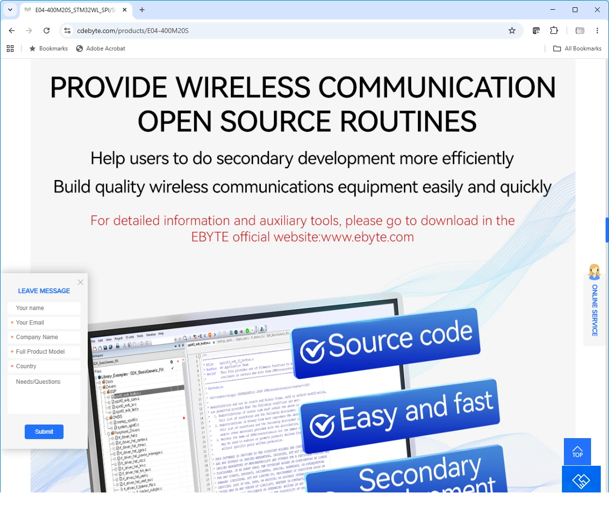

@nabilkontar  wrote:
It's a E04-400M20S
So this: https://www.cdebyte.com/products/E04-400M20S ?
Always best to give a link - so people can be sure what you're referring to.
That page says they have open-source code available:
have you looked at that, to see how they manage their TCXO ?
Aug 22, 2026 5:10 PM UTC
Hello Andrew,
Yes that is the module.
Thank you for the advice. In the process of communicating with them and asking them for sample code. Will post it here once it works (or if i made a mistake somewhere).
Went as far as de-soldering the shield to make sure PB1 is the correct pin.
Thank you again!
