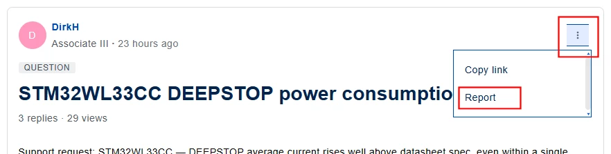

Andrew Neil
Sep 1, 2026 11:35 AM UTC
You can request a moderator to remove the email address - use the ‘Report’ option in the menu:
