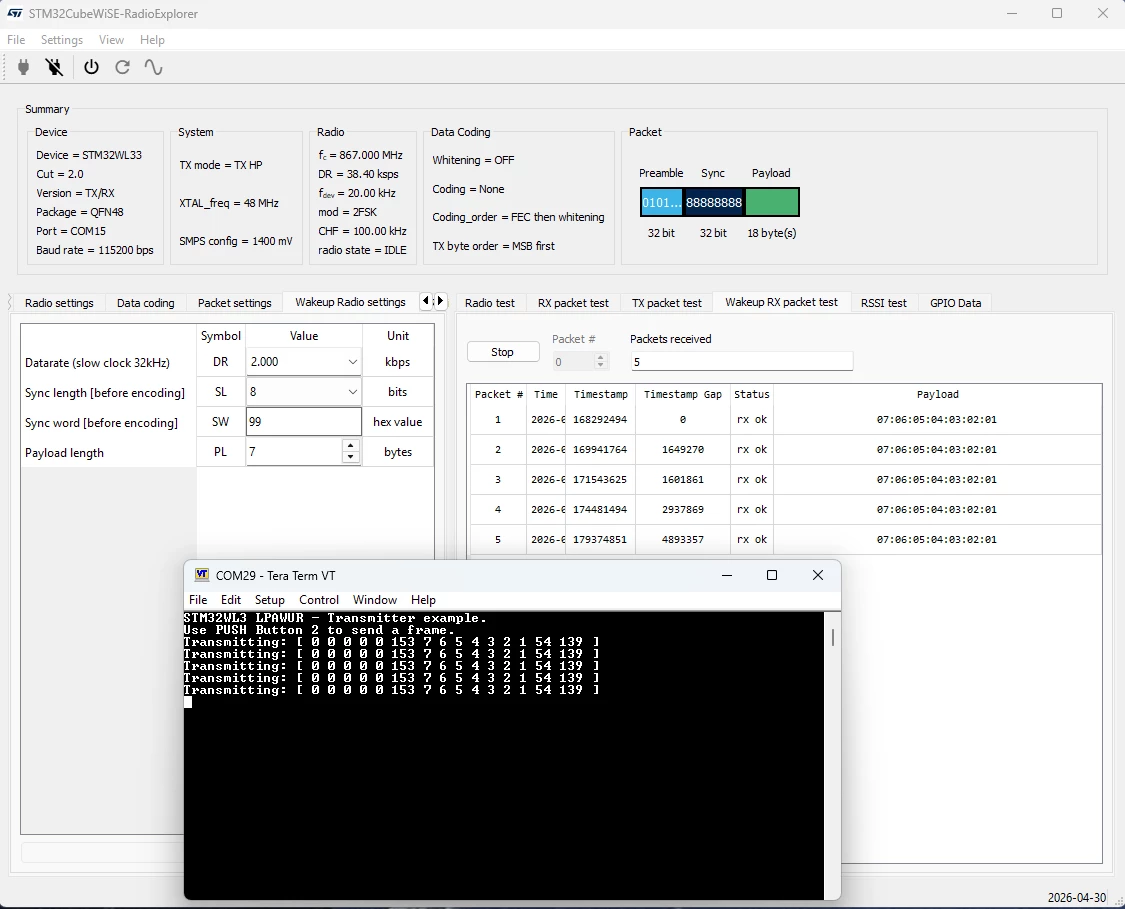

use the STM32Cube_FW_WL3_V1.4.0\Projects\NUCLEO-WL33CC\Demonstrations\MRSUBG\MRSUBG_WakeupRadio_Tx project for the transmitter, and set 20 dBm as output power and PA_DRV_TX_TX_HP as PA drive mode.
use the STM32Cube_FW_WL3_V1.4.0\Projects\NUCLEO-WL33CC\Demonstrations\Command_Line_Interface\CLI project for the receiver, so you can use the STM32CubeWiSE-RadioExplorer (I suggest latest version, v1.3.1)
In the RadioExplorer, connect the RX board and click the Config button in the System settings, Radio settings, Data coding, Packet settings and Wakeup Radio settings menu. Then, go to Wakeup RX packet test and click Start.
For more information on how to use the RadioExplorer, here is the documentation: https://www.st.com/resource/en/user_manual/um3400-stm32cubewiseradioexplorer-software-description-stmicroelectronics.pdf
Push the B2 button on the TX board and you will see the incoming packets in the RadioExplorer.
The range of the LPAWUR is at least 10 meters in line of sight.
The AGC is not involved in this scenario, it works at high power to reduce the incoming power.
