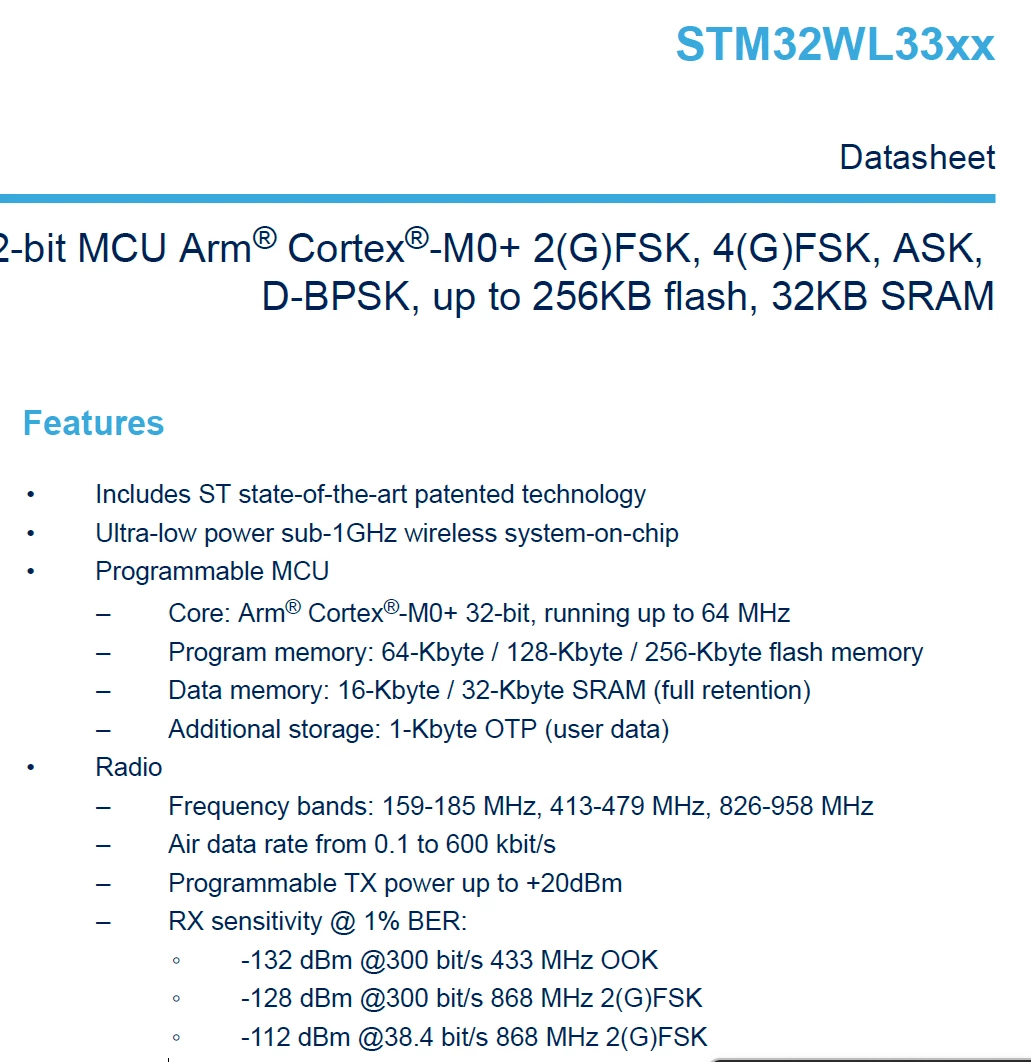

stm32wl33 docs has wrong?
at stm32wl33 datasheet there is RX sensitivity topic but i think wrong
– RX sensitivity @ 1% BER:
◦ -132 dBm @300 bit/s 433 MHz OOK
◦ -128 dBm @300 bit/s 868 MHz 2(G)FSK
◦ -112 dBm @38.4 bit/s 868 MHz 2(G)FSK
it should be kbit/s .

Hello ​@fixaj ,
This typo has been corrected in the new DS14221 - Rev 7 that has been published this week in ST web page.
Thank you again for having reported this error. This is helpful for us to improve our documentation.

Hello ​@fixaj
Thank you for having reported this.
An internal ticket is submitted in order to correct this typo (Internal ticket number: CDM0065460)
(PS: ticket number CDM0065460 is an internal tracking number and is only for reference, not accessible or usable by customers).
