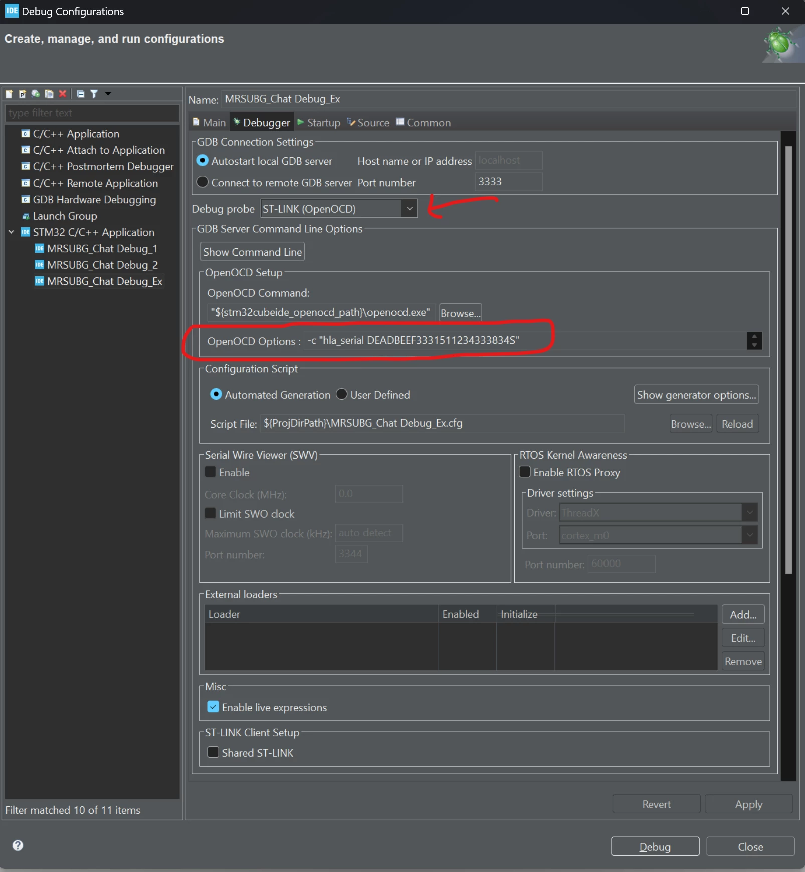

Hi All,
While ST sort out the bug reported in this thread. In the meanwhile as a work around we can use OpenOCD as a debugger and connect to multiple boards using the following steps outline below.
  1. Select Debugger tab for Debug Configuration
  2. From Debug probe using the drop down combo box select ST-LINK (ST-LINK GDB server)
  3. From the Interface section check the ST-LINK S/N radio button followed by pressing the Scan button. This would populate the combo box with list of board serial number attached to your PC.
  4. Identify each boards serial number and create separate configuration for the board as show below do forget to click apply to save your changes.
  5. From Debug probe using the drop down combo box select ST-LINK (OpenOCD)
  6. In the section OpenOCD Setup, enter into the Edit box -c "hla_serial DEADBEFE3331511234333834" Note that the -c is not in the quoted string but outside.
  7. Click apply to save your configuration.
  8. Happy debugging

Hello @ola
Thank you so much for the work around you have implemented, I suggest you sold SB30 (on the back of the MB180-NoUSB-D02) board.
PS: this should work fine will using the MB180-NoUSB-D03.
Best Regards.
STTwo-32
olaAuthor
January 8, 2025
Hi STTwo-32,
I can confirm that by soldering the SB30 connection located on the back of the NUCLEO-WL33CC1 causes the ST-LINK(ST-LINK GDB server) Debug probe option to work.
Many thanks one again.
