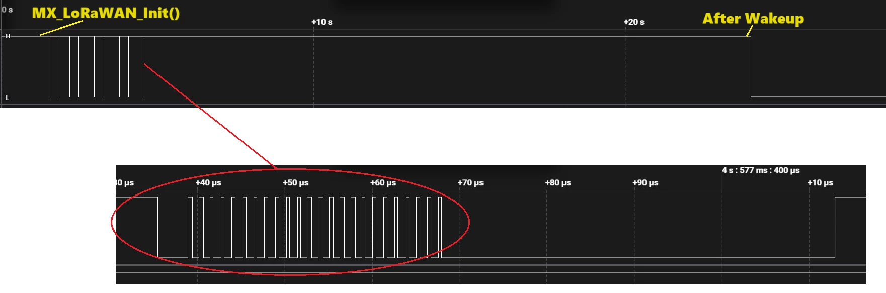

Hello Everyone, I'm driving the WS2812 RGB-LED using TIM16 CH1.
I have a very similar behavior as in this_post . The RGB works well just until MX_LoRaWAN_Process(void) then it doesn't work. I tried his solution but it didn't work(although I suspect the SYSTICK is not working).
The Waveform looks like this:
The solution in the post(using the following lines) didn't work for me:

I also printed out the content of the LED_DATA_ARRAY(which contains the color data) and it seems fine.
The Mode is STOP-Mode2. What would be the problem here?

Hello @AElgh
Are you disabling the Timer clock before entering the STOP Mode. If so, try to keep it enabled.
Best Regards.

Hi
This issue comes when I deactivate the  Debugger(DEBUGGER_ENABLED --> 0).
When DEBUGGER_ENABLED    1, everything works fine but as i need lower power consumption i want to deactivate it.
In an5406 it mentions that "The debug mode enables the SWD pins, even when the MCU goes in low-power mode."
however, neither PB8 nor DMA has anything to do with the serial-wire-debugging feature.
I'm trying to understand how to shut the debugger without interrupting the Functionality.
