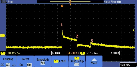

We periodically start a conversion for multiple channels by timer, with DMA.

Monitoring an input channel with a scope, there is a big glitch on the signal, that does not seem commensurate with the input capacity of the ADC or the output impedance of the amplifier. What can be the cause? And can we suppose that the sampling ends at point 2 of the trace? In this case also the value on sampling capacitor is wrong.
