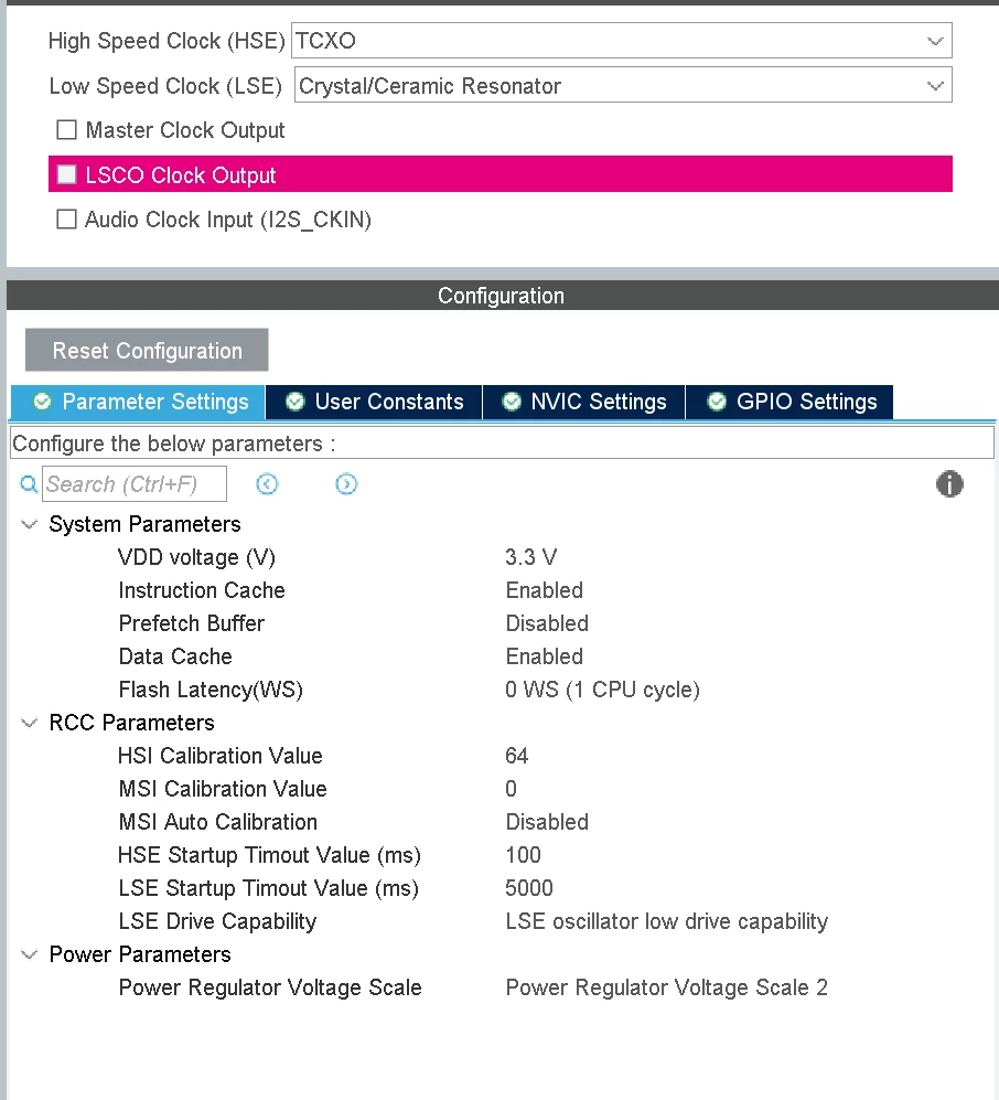

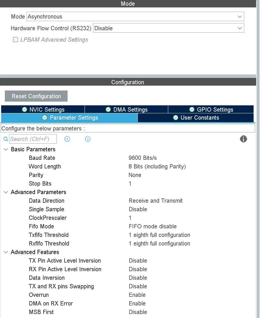

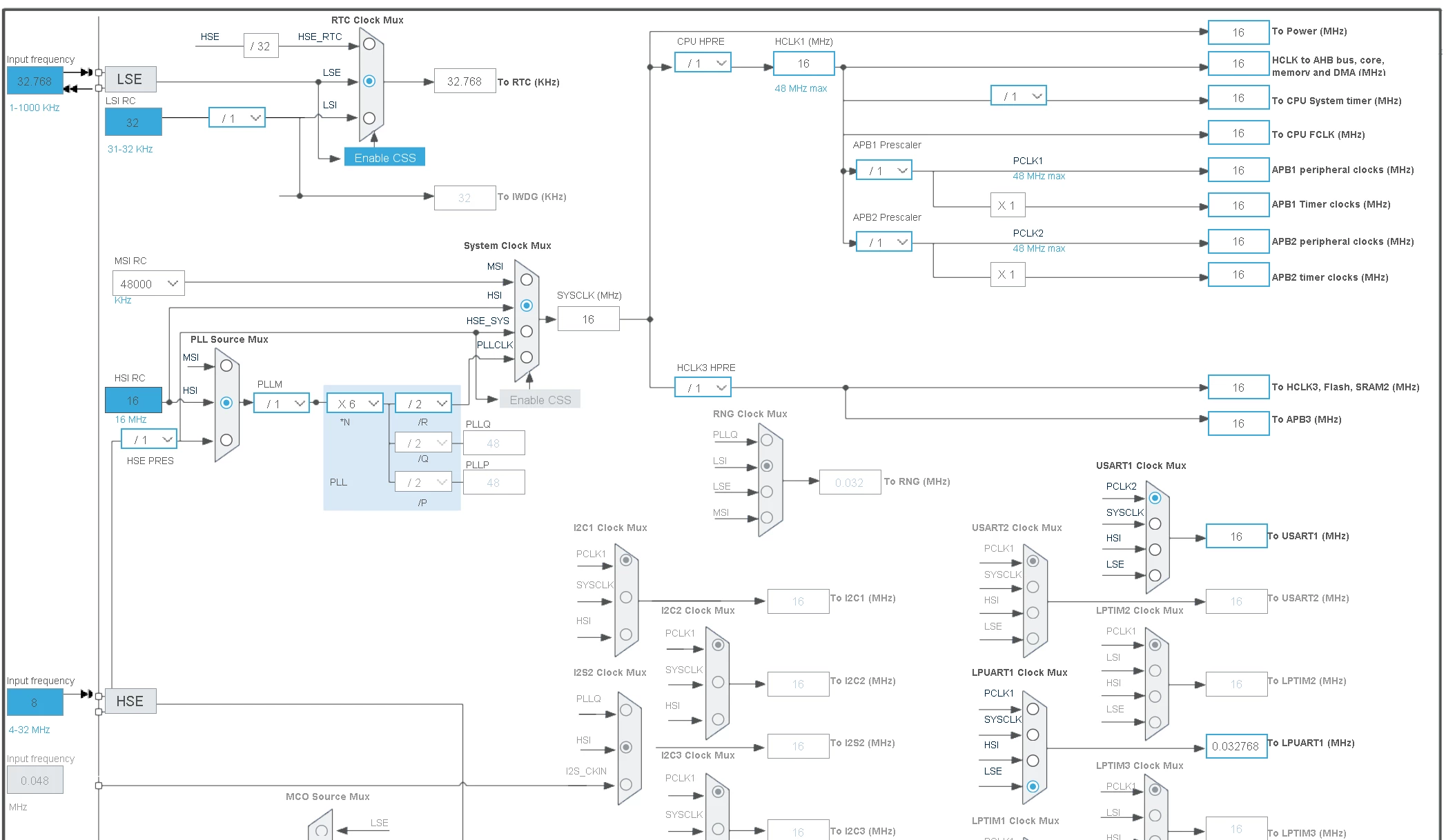

Hello folks,when I was using the HAL library function to implement MCU wake-up service from STOP2 mode through LPUART serial port, I found that no matter how the data was sent, the MCU could not exit STOP2 mode. Below are the relevant configurations configured by my cubemx,the MCU I am using is STM32WLE5CCU6.

I just referred to the official routine and took a small section of the code for the first wake-up, but my test results showed no response. The wake-up callback function HAL-UARTEx-Wakeupcallbacks seems to have not entered.
