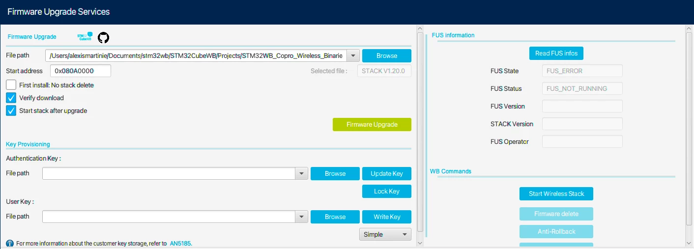

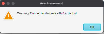

I am currently working with the STM32WB Nucleo Boards. I wanted to flash the stm32wb5x_Zigbee_FFD_fw.bin on the Dongle. However, when I start the firmware update, this message appears:
Here the firmware upgrade service window:
Does anyone know a solution to that issue?

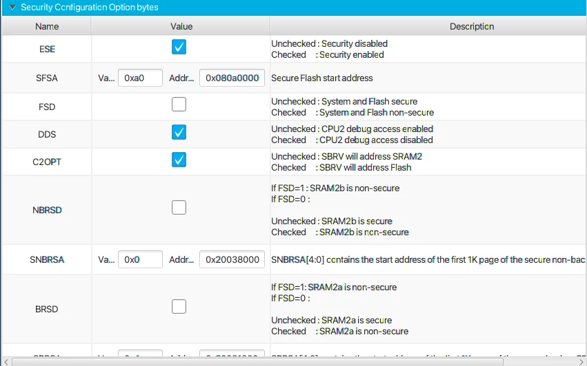

Hello @maestrmx19
Could you please share the content of your option bytes. Also, please give me the procedure that you have been following to download your Stack binary (mention the version of the CubeWB version that you have used and the Cube Programmer that you are using).

Hello @STTwo-32 ,
For downloading the Stack library I used :
git clone --recursive https://github.com/STMicroelectronics/STM32CubeWB.git
And I used the Stacks located in: Projects/STM32WB_Copro_Wireless_Binaries/STM32WB5x/
- Cube Programmer version: v2.17.0
- CubeWb version: v1.20.0
Option bytes: RDP : AA
                      BOR_LEV : 0
The procedure I have been using:
After putting the Dongle switch to BOOT0 I connect it to the Cube programmer with USB.
And in the Firmware Upgrade Services tab I juste put my Stack's file path and click on Firmware Upgrade.
I hope my explanation was clear enough :) .
Best Regards.

Hello @maestrmx19
Please add all your option bytes output here. Also, take a deep look to this wiki page. It should be really helpful.
