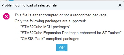

stm32wba65 and I-CUBE-LRWAN
I have a custom board with stm32wba65 processor. I also have an RFM95 LoRa module. I need to add LoRaWAN capability. I tried adding I-CUBE-LRWAN into my CubeMX but was not able to load it (not a recognised package).
How can I get an ST or Semtech approved LoRaWAN stack into my project?
Please do not suggest I use stm32WL processor.

Andrew Neil
Jan 21, 2026 11:24 AM UTC
Indeed, I-CUBE-LRWAN is not a "Package" in the CubeMX sense.
It's just a load of source code, which you add to your project manually. Or start from one of the supplied examples in it.

Ok, so I took the example for stm32L476, and copied the LoRaWAN folder across.
How do I specify that we are using:
  1. RFM95 (sx1276) board
  2. stm32WBA65 processor
  3. spi3 for comms
  4. PC13 for CS
Is there a header file to set this up? or do I just edit the .c files directly?
Andrew Neil
Jan 21, 2026 12:04 PM UTC
The processor you specify in the IDE Project;
The other stuff, as mentioned in the linked thread, is all done in the HAL code.
