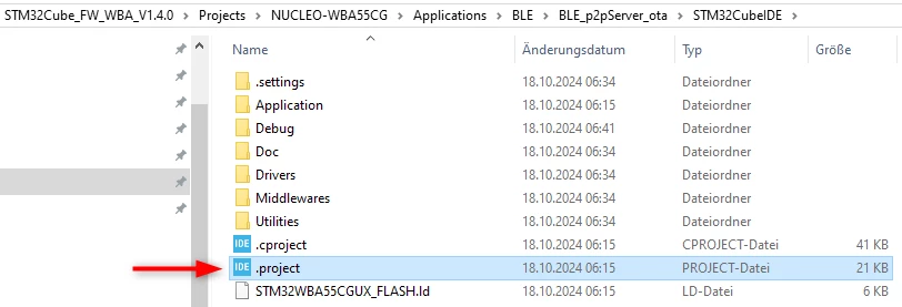

I startet the project directly from the regarding project file in the FW-Package:

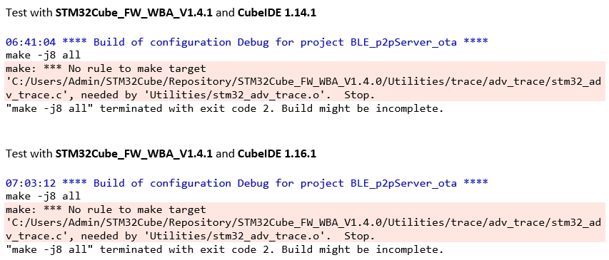

But i got these error messages:

STTwo-32Best answer
Oct 18, 2024 8:24 AM UTC
Hello @ledi001
To make the code work you have to: go to CubeMX and generate the project "BLE_ApplicationInstallManager" using your CubeIDE, compile and download it. After that, do the same using the "BLE_p2pServer_ota" project.
It will work perfectly.
For the issues, I've personally been able to use the projects on the STM32CubeIDE V1.16.1, STM32CubeMX V6.12.1 and STM32CubeWBA V1.4.1. Just generate them using STM32CubeMX. If the issue persists, you can keep using the V1.2.0. it should be the same Methode that I've explained before.
