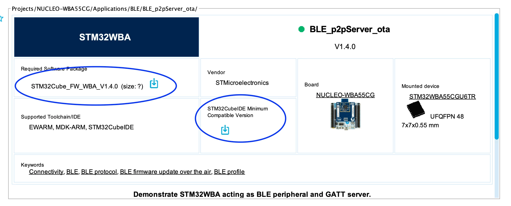

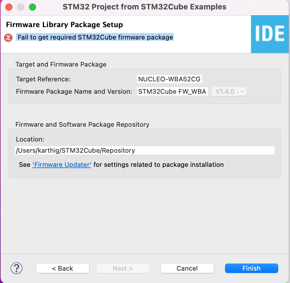

STM32WBA55 "Fail to get required STM32Cube firmware package"
Unable to import projects from Example selector, I have installed latest CubeIDE
It shows FW_WBA_1.4.0, But I can see only FW_WBA_1.3.1 in github or st.com
Thanks

Jun 19, 2024 10:07 AM UTC
Hello @Karthi
Thank you for reporting this issue, I've been able to reproduce it on my side and I've escalated to the concerned team for fixing (on the internal ticket 184499).

Jun 21, 2024 7:15 AM UTC
Hello @Karthi
The issue has been fixed. Please try again on your side (don't forget to login to Your CubeMX so it can update his files).

Jun 22, 2024 8:08 AM UTC
Hi @STTwo-32  Thanks issue resolved
