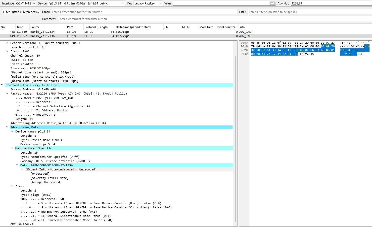

1. Advertisement Issue: Discoverable in iOS/Windows not in Android
- Board: NUCLEO-STM32WBA52
- MCU: STM32WBA52CGUX
- SDK: 1.14.0
- Due to unavailability of out of box any BLE example code for STM32WBA52 series,
  Used base code for STM32WBA55 series and converted firmware for STM32WBA52,
  Tried examples: peer_to_peer_server_ota, heartrate_ota and beacon.

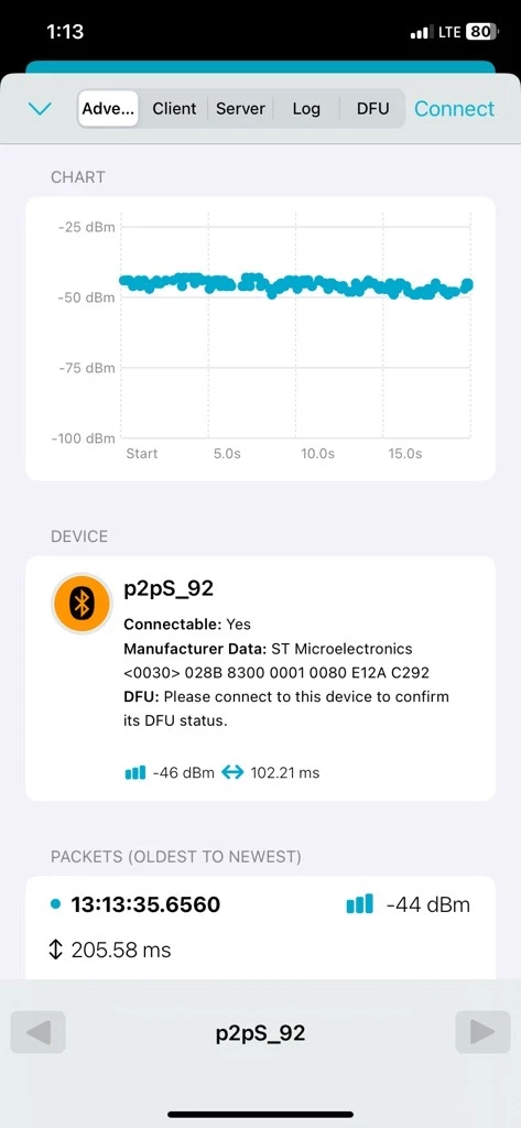

- Found strange case for all three examples that:
  Device advertisement found in iOS(BLE5.3) and Windows(BLE5.0), with good RSSI around -26dBm to -34dBm,
  even able to connect, read, write and notify perfectly,
  But device advertisement not found in Android phones:
  MI-11X(Android-V13, BLE5.1), Nokia-G42-5G(Android-V13, BLE5.1)
- peer_to_peer_sever_ota (STM32CubeIDE) advertisement found in windows and iOS related screenshots attached here.
fa097269-708d-4026-8346-30d40f165533.jpgRef: Windows discovered advertisementRef: Windows discovered advertisement
- Related peer_to_peer_server_ota firmware attached here for reference(7zip need to extract same).
- Related sniffer based packet info:
