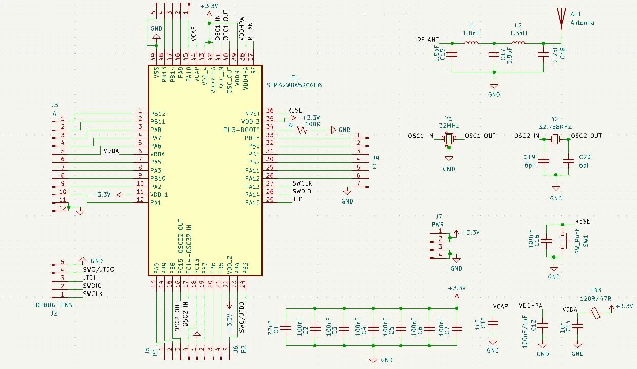

I am trying to detect my stm32wba52cg bare chip with my developed custom PCB board with onboard stlink as external programmer from a discoveryboard but its showing this msg-
Can not connect to target!
Please select "Connect Under Reset" mode from Target->Settings menu and try again.
If you're trying to connect to a low frequency application , please select a lower SWD Frequency mode from Target->Settings menu.
No target connected.
this are my connection for programming my wba52 controller-
discovery stlink                    stm32wba52
swdio                                          swdio
swclk                                           swclk
nrst                                               rst
3.3 (from discovery board)           3.3
gnd                                               gnd
Below is my schematic attached:
I have exposed all the pins.

As I can see on your schematic, you are using the PA13 as SWCLK and PA14 as SWDIO. But as you can see on the Table 24 of the DS14127, PA14 is the SWCLK pin and PA13 is the SWDIO pin:

PA14 is the SWCLK pin and PA13 is the SWDIO pin i swaped the pins and it detected the mcu but I am getting Target is not responding message every time I try to run or debug the BLE_heartrate_ota example for stm32wba52.
