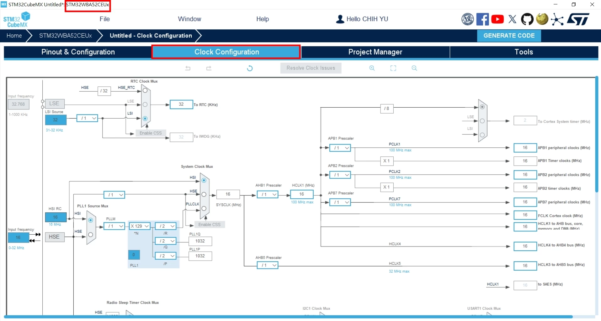

Got a new MCU with LSI2 from the distributor. I want to use it for the 2.4 GHz RADIO sleep timer, but can't find LSI2 register settings in STM32CubeMX.
Additionally, I'm curious why the STM32CubeWBA version V1.3 doesn't support the STM32WBA52 series product.

Unfortunately, the LSI is not available for the moment,
if needed you can find the info under "Know Limitations" in this Release_Notes
